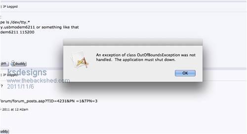

Nope
An exception of class OutOfBoundsException was not handled.
the application must be shut down.
this is on Lion

  ksdesigns said   Nope
this is on Lion
ken
Hmm. Happens when there is no serial port found by the system.

its going to have to search thru /dev/tty. some how .
possibly a config screen for it ?

  ksdesigns said   its going to have to search thru /dev/tty. some how .
ken
I'm using the very same Mac code I used on another serial port project. Worked with a Mac with several Prolific USB/serial attached. I suspect the Maximite does not show up as a serial port the way that the adapters do.
