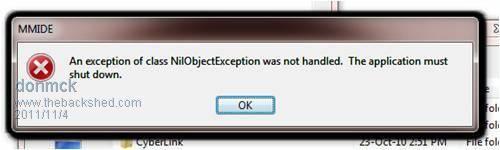

CG, I tried to run MMIDE.exe
Got this error:
Had to run task manager to break out of it.
Running Windows 7 64 bit.
Cheers Don...

This could be very handy, CircuitGizmos. You wanted bug reports, so here's mine.
I downloaded MMIDE and tried it under XP2. The MMIDE terminal window appeared, then a dialog box appeared containing the news that:
"An exception of class NilObjectException was not handled. The application must be shut down." The app then froze. The dialog box and the MMIDE window were not responding wither to click on the Close button nor to attempts to drag them using their title bar. All other windows were working.
Clicking on the OK in the dialog box had no effect. Clicking on Exit in the main window did nothing. Even if nothing is clicked the application closes after about 30 seconds.

Rob, remember I mentioned that yesterday Sparkey came and got my last Maximite that I had at home, so I had nothing to test it with?
Well as it turns out, I had no serial port on my laptop.
I plugged in an FTDI converter board, and tried again. Came up with COM5:, so I checked the device manager, and sure enough, COM5 has an FTDI device plugged into it.
First test, make sure you have a serial port, else program runs amok.
Can you perhaps report, "No Serial Port Found"
Sorry, I can't test it further until possibly Sunday.
Cheers Don...
EDIT: Bruce, what you ended up with is pretty much what I got with no serial port installed.Edited by donmck 2011-11-05

That was the problem I expected. I will beef up the code to handle the case where there is no serial port.
Bruce - in virtualbox do you get a serial port?
