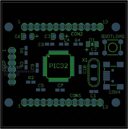

Prices for a PCB still seem a bit steep for those of us with little or no budget (me) in the USA. Would anyone mind if I took a stab at trying to fit the Mini' design into a 50x50mm footprint (see below) to take advantage of the Seeed Studio Fusion PCB service (10 boards for $13 USD)?
I'd love to hear your comments, even if you're one of the many people here with a monetary interest in the Maximite.
Cheerful regards, Mike

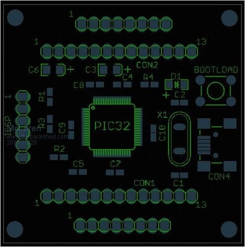

I really like this but I would suggest adding the Keyboard, VGA, SD card connections back in but on the sides as seen below. This way we could create another board that stacks on top with those connectors (similar to the way a shield board plugs into Arduino).
This way the square Maximite board could be plugged into a breadboard or even built into a permanent design but for those that don't want to program with a USB/terminal program, they can plug a VGA/Keyboard/SD board on top to develop. When their done, unplug the top board and run the project or leave it in to drive a display.
I also moved the holes out to the corners as an option as well. If I use metal standoffs to hold the stacked boards together then having them further out reduces the chance of shorting to components.
Beyond this we could make stackable boards (like Arduino shields) to plug in on top such as an RS232, relay or LCD board. A Maximite tower of electronics.

Hi El,
That's almost exactly what I had in mind. I just got ahead of myself and posted early because I was so excited to see how the mini' will fit inside a 50x50mm footprint.
I've got mid-terms starting Monday so I can't do much with this now but I think I'd like to try doing this sometime soon.
Regards, Mike

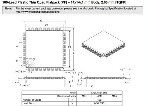

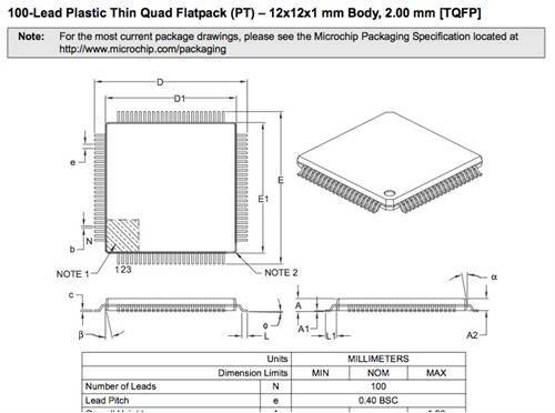

Bear in mind that the board in Mclaren's link is 0.5mm spacing. AFAIK the 100 pin PIC32 are all 0.4mm. Fortunately, if you go to their webstore, they also have a 0.4mm version.
elproducts
Joined: 19/06/2011
Posts: 282
Posted: 12:22pm 12 Nov 2011
The data sheet shows both a 0.5 pitch version and 0.4 pitch version.
So I assume this is using the 14x14mm version.
www.elproducts.com

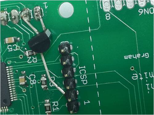

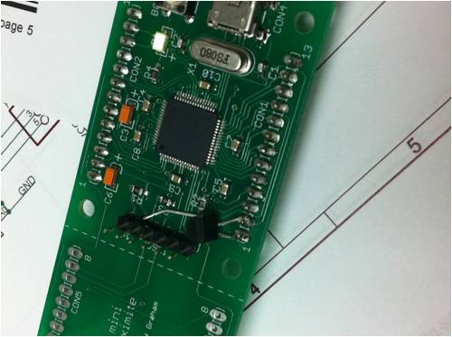

I finally got all the pieces together to build a Maximite-Mini.
After finding and fixing a USB connector solder problem I have it running successfully.
I also added a 3.3v LDO to the design so I can power it directly from the USB port. This is an easy addition since the circuitry already has all the output filter caps required(a 5v filter cap may be required if you run this off the USB port).
I used a Microchip Part Number MCP1700-3302E/TO
You can get these at Digikey, Mouser or MicrochipDirect.com for under $0.50.
It picks up USB 5v from CON1 pin 2 and ground from CON1 pin 1.
The 3.3v output connects to the 3.3v bus at the ICSP connector pin 2.
The leads are just bent to line up with those pins.
Hopefully these pictures tell the story.
