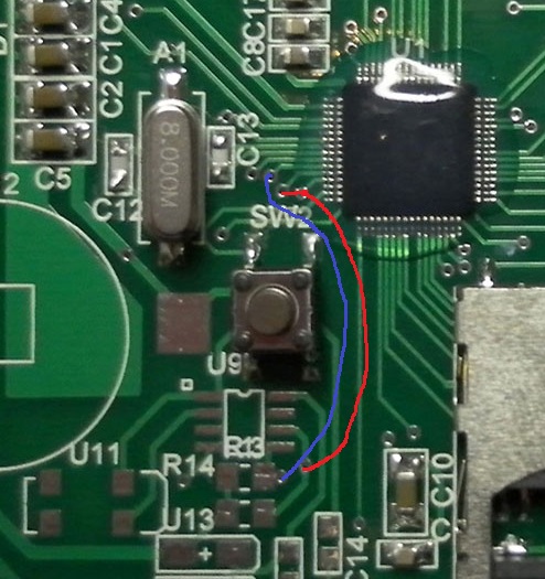

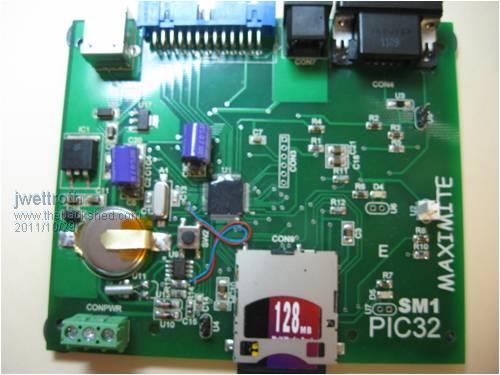

I noted on the SM1 schematics and board that there is a place for an RTC. I studied the schematics a bit and thought that it would be a matter of populating the parts and writing a little I2C hack in basic. Unfortunately unlike the SPI mode, the I2C commands only address pins 12 and 13 directly. It also looks like the designer of the board thought he was connecting to an alternate SDA and SCL but made an error and used one line but not the other. I considered hacking something in assembly and recompiling, etc., etc. but came up with something simpler. I put the RTC chip down on the board and then connected it to the regular I2C port that is supported by basic. Due to some fortuitous routing and placement of via's, this is a pretty clean mod.
I ordered a PCF8563 and populated the other parts as in the schematic. I kluged up a coin cell holder from some brass stock I had laying around as can be seen. (it works...). <see photo- RTC Long Shot>

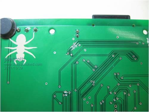

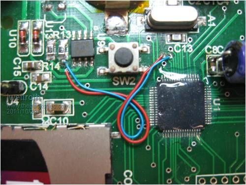

I then cut the track from the SDA and SCL lines on the back of the board. <see RTC Track CUTS>. There are via's at both ends of these tracks so if I want to restore thing later, I can run a jump from the respect via's.
Finally I connected the SDA and SCL line to the standard I2C. This could be done at pin 12 and 13 on the connector- but there are two via's close by as shown in the top side picture. <see RTC WIRES DRAWN and RTC WIRES>
I then can use the code that was contributed on the forum for the internal I2C board that was bought on EBay and used the PCF8563. It works well.
Also note that since I2C is multidrop, having one thing hanging on it doesn't really hurt anything as long as there is no address conflict.
Thanks to the group for all you sharing and I hope this will be enjoyed.

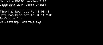

OK. Here is the working code for the RTC in an Altronics Maximite using an eBay RTC (8563) that has been mounted directly onto the ICSP header with the two tracks to the PIC32 cut and two wire links to I/O pins 12 and 13 (SDA & SCL).
The time and date needs to be set first using DATE$="DD/MM/YYYY" and TIME$="HH:MM:SS"
Use the PRINT DATE$ and PRINT TIME$ commands to confirm the time and date.
Next run the WR8563.TXT file. I renamed the file to SETTIME.BAS and I have it below.

Once this has been done, turn off and on the Maximite. Check the time and date as before. (PRINT DATE$ and PRINT TIME$ commands to confirm the time and date).
If it shows the correct time and date, you're good to go. If you want to have the correct time and date set and shown on startup, you will need to add some extras to your AUTORUN.BAS file. Here is mine as an example.
