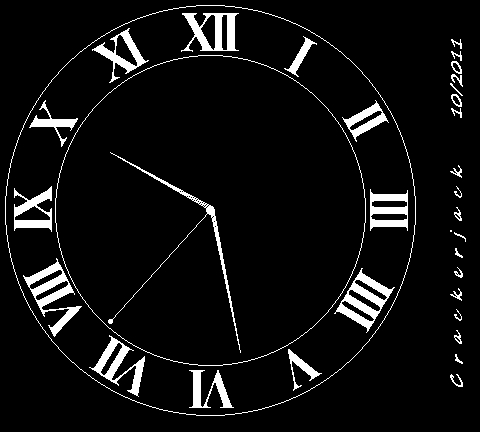

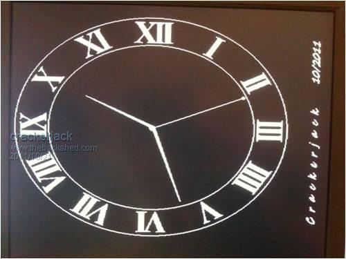

The evergreen Analog Clock gets some treatment here... but really just as an example of what can be done using converted bitmaps as a background. See this post and this code for details on this.
Back to the clock...
Photo of the VGA screen:
Screenshot using the SAVEBMP command:
The Maximite is never going to be an Apple-killing graphics work station, but some nice little effects can be obtained - and hey, it's so much fun...
I guess gauges and backgrounds of all sorts could be preloaded and then actual measured data displayed within the "blank" zones. jman's neat In-Car Console Display from a month or two back springs to mind as a perfect place to use this type of approach.
Code for the clock is zipped and available here including a "blank" bitmap of the Roman Numeral clock face. Checkout the Converted Bitmaps link above on how to convert bitmaps to a snappy format the Maximite likes.
Also, the minute- and hour-hand rendering code is far from perfect and leaves the pointers looking a touch "skinny" at certain times of the day. Easily fixed, but those hardware projects beckon...

For anybody interested, there is a small update to the code to make the clock behave more like a true analog clock:
- the hour and minute hands are now rendered in a uniform way regardless of their position on the face;
- the second hand extends beyond the clock center in both directions;
- the hour hand indexes according to the number of minutes passed in the hour - e.g. it would be halfway between 10 and 11 at 10:30 AM (not left pointing at 10 with a sudden "snap" to 11 as the hour passes).
Also there is an annoying tick-tock sound (which may be switched on/off at program start).
The math/trig is probably a bit cryptic in the code as it is not commented - but digging through it you will see a way of rendering rotary gauge-like pointers (or needles) of arbitrary "weight" or "thickness" as is done with the hour and minute hands.
The Maximite is quite a marvellous little beast - it only takes about 7 milliseconds to run the entire Time Display routine leaving about another 993 milliseconds of not doing much at all while we wait for time to pass...
