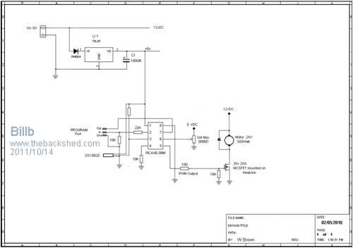

I have built a controller for a 24v 300w (only used a 12 volt supply for the motor) using the 08m with a power MOSFET to drive the motor and a ds18b20 temperare sensor.
additional information can be obtained from

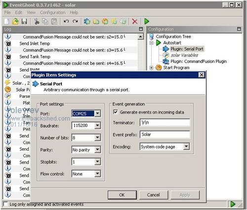

Its a free program that you run on a pc. What is does is monitor events that happen on serial ports or infrared devices (and many more ways: TCP/IP,UDP and on screen). In it most simplist form you can monitor for an event and send a pre made reply. As it would happen Maximite turns up as a serial port so configure the eventghost session on the PC you are using to monitor the serial port in the Autostart folder on the config tree. See below.
Ok so as you can see I have made the event prefix Solar and the terminator \r\n (newline and carrage return)
now anything that Maximte generates come into event ghost as Solar.
using Solar. plus a wildcard "*" you can make eventghost look at the information comming form the Maximite program

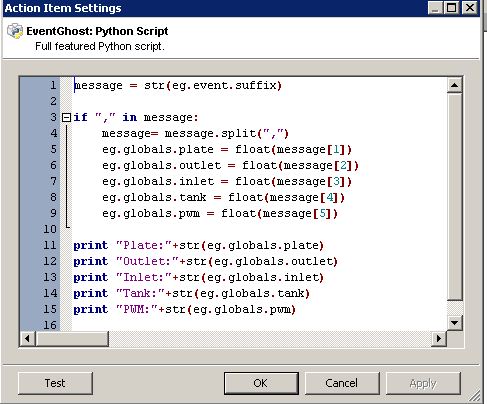

Now as you can see I have some eventghost python script. This is to allow access to python variables and "pull apart" the Maximite solar messages.

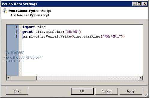

Finally the date and time, Maximite asks the time question with a time. event, this turns up in eventghost as Solar.Time. This in turn triggers an event (written in python) to send back the current PC time
the date portion of the reply is similar but uses eg.plugins.Serial.Write(time.strftime("%d-%m-%Y\r")) to output day - month - year (the \r is carrage return)

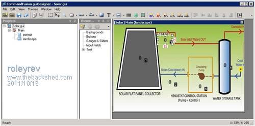

I am using a program called command fusion (this also has an eventghost plugin) to view the temps on my iPod touch. You can use command fusion for free on a single page loyout.

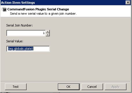

Each if the 0 figures with a small number beside it is a serial joint, this allows Eventghost to send real numbers to the layout on the iPod with the real temperatures and Motor PWM
You can see here the serial join Number is one and this represents the plate temperature. The variable eg.globals.plate is defined in the autostart part of eventghost and gets it value from the parsed output from the Maximite
