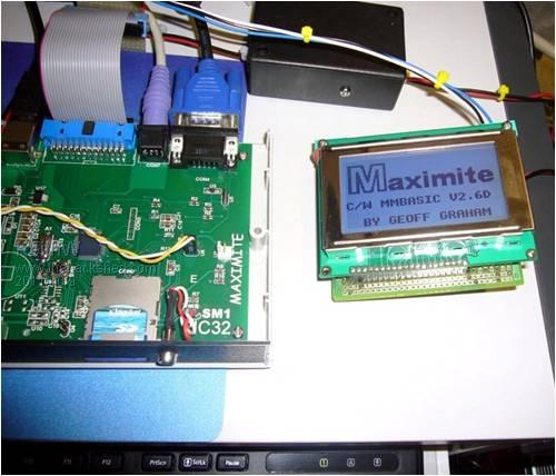

I was tempted to buy a Displaytech 64128A 128 by 64 Graphic LCD Display from Rockby Electronics at the price of $7 each. I am also interested in I2C for a larger project. To start I have used a Picaxe 28X2 to drive the display to preserve Maximite pins, using I2C for communications with the Picaxe. I required 14 pins to drive the display. Believing that a Maximite graphic was required I scanned the Enclosure Label from page 90 of the April “Silicon Chip” article, some pixel editing and then I created a pixel ascii hex text file. A little Maximite program converts this SD card text file to a binary file. Graphic and text and position information may then be transferred from the Maximite SD card to the Picaxe. A limited small character font (capitals and digits and 5 other letters) is squeezed into the Picaxe-28X2 256 byte EEProm. Display commands are: - Clear screen, Position to X-Y, Load Graphic Pixels and Display Ascii text. The Picaxe and display is limiting update speed. The MMBASIC code employs delays between messages to the Picaxe though some I2C messages themselves contain 250+ bytes. The LCD screen has separately enabled driver chips for the left and right halves of the display. This complicates the Picaxe code to automatically switch halves. I was assisted in my project by another displaying test on a graphic LCD found on the web.

I was looking for a quick answer. Interested in driving the LCD. The original graphic was anti aliased and my scan was jaggy although I ended up with a .bmp after editing. I then cheated and hand coded the graphic, only 512 pixels.

I have zipped up the Picaxe code and the circuit of the picaxe driver card behind the display. The circuit is in two parts because it is a screen grab from Diptrace. Perhaps it is only in the free version but you cannot seem to save the schematic in anything but the Diptrace format.
The picaxe acts to interpret the I2C messages and drive the screen. I hope that you can work it out. I will continue to look for the Maximite code that sends some test messages and the graphic data file at least. I did not go further with this project; something else must have been more interesting. The particular picaxe had just enough rom memory to squeeze in a simple capital font in compacted data format c/w numerals. The font is from the old BBC computer and designed to look OK with minimal size. The Micromite can manage must more than that. Rockby Electronics still have 128 * 64 LCD displays at ever decreasing prices.

David it was slow, would not recomend it for graphics but may find a place in some application. I have not found one yet, still sitting in a box. From memory it was the display that limited the speed, taking ages to swallow the data and the write handshaking did not work correctly. The picaxe did not set the world on fire.
Have used many othe character LCDs with less trouble.
Perhaps if these display were OK (useable) they would not be $7 each.
