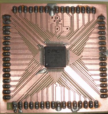

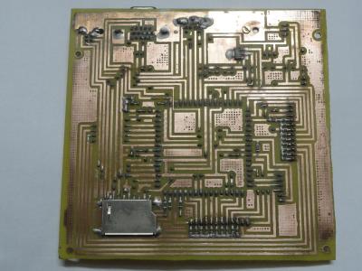

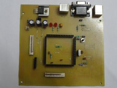

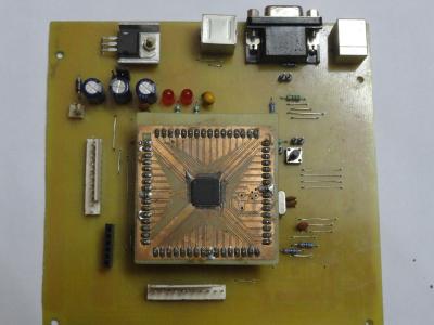

Here is my first attempt to a home-made single sided maximite board using the quick 'n' easy toner transfer method. It has some vias as expected but I think that is OK for a home-made design. It was built in under 2 hours including soldering and firing up the MMBASIC. It did not boot for the first time because I used capacitor "C5" as electrolytic. ITS VERY IMPORTANT TO USE A TANTALUM CAPACITOR FOR C5. Everything works as good as it was meant to be. Here are some pictures....
1.Back Side
2.Front Side
3.Front Side with PIC32
4.PIC32 adapter for easy replacement and soldering.
Images may seem bad due to reflections.Edited by Sumit 2011-09-24

Did you make the carrier board for the PIC32? The tracks need to be very close together which is difficult on a handmade board.
Also, what is the silver thing on the underside of the board? A shield? Bluetooth?

I think that's the SD card socket.

i argree with others ..where did you get the cct board that holds the pic and have yo made full use of all the pins that are actully avaliable from the chip point of veiw

I made the PIC32 adapter board using EAGLE version 5. I had to make my own device library because EAGLE does not have a PIC32 device library by default. For that, I had to edit the TQFP64 libraries from other devices eg. LPC2148 from NXP, that has the same package. It took some time but the effort is worth it. This enables me to re-design the main board without much effort since I already have the PIC32 "adapters" easily made.
