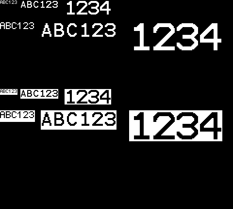

Inspired by the efforts of Gizmo and jman to draw large numbers I have put user selectable fonts into this new version of MMBasic. There are now three standard fonts:
- The basic font of 10 x 5 pixels.
- A larger font of 16 x 11 pixels.
- A jumbo font of 30 x 22 pixels consisting of the numbers zero to nine and the characters plus, minus, comma and full stop.
You can select between them with the FONT command. You can also scale a font to x2, x3, x4, etc in size and you can display the characters in reverse video.
The image shows all three fonts on the first line. The second shows all three but scaled by 2 (ie, doubled in size). The last 2 lines are the same as the first two but with reverse video selected.
