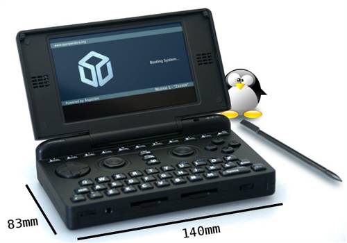

Hi Sparkey,
Look at this little jewelry, is very small, can host your Maximite, can communicate and report to your Bluetooth phone or printer (thought, it don't need that 'cause it can do all your graphs and processing you need and store on SD Cards), can be programmed in freebasic or Gambas or anything, can have a normal PC keyboard and an LCD ... better read the specs:
# Texas Instruments OMAP3530 processor at 600MHz (officially)
# 256MB DDR-333 SDRAM
# 512MB NAND FLASH memory
# IVA2+ audio and video processor using TI's DaVinci™ technology (430MHz C64x DSP)
# ARM® Cortex™-A8 superscalar microprocessor core
# PowerVR SGX530 (110MHz officially) OpenGL ES 2.0 compliant 3D hardware
# integrated Wifi 802.11b/g (up to 18dBm output)
# integrated Bluetooth 2.0 + EDR (3Mbps) (Class 2, + 4dBm)
# 800x480 resolution LTPS LCD with resistive touch screen, 4.3" widescreen, 16.7 million colors (300 cd/m2 brightness, 450:1 contrast ratio)
# Dual analog controllers
# Full gamepad controls plus shoulder buttons
# Dual SDHC card slots (up to 64GB of storage currently)
# headphone output up to 150mW/channel into 16 ohms, 99dB SNR (up to 24 bit/48KHz)
# TV output (composite and S-Video)
# Internal microphone plus ability to connect external microphone through headset
# Stereo line level inputs and outputs
# 43 button QWERTY and numeric keypad
# USB 2.0 OTG port (1.5/12/480Mbps) with capability to charge device
# USB 2.0 HOST port (480Mbps) capable of providing the full 500mA to attached devices (examples include USB memory, keyboard, mouse, 3G modem, GPS)
# up to two externally accessible UARTs and/or four PWM signals for hardware hacking, robot control, debugging, etc.
# un-brickable design with integrated boot loader for safe code experimentation
# Power and hold switch useful for "instant on" and key lockout to aid in media player applications on the go
# Runs on the Linux operating system (2.6.x)
# Dimensions: 140x83.4x27.5mm
# Weight: 335g (with 4000mAh battery)
Is the "RE" PC we need.
