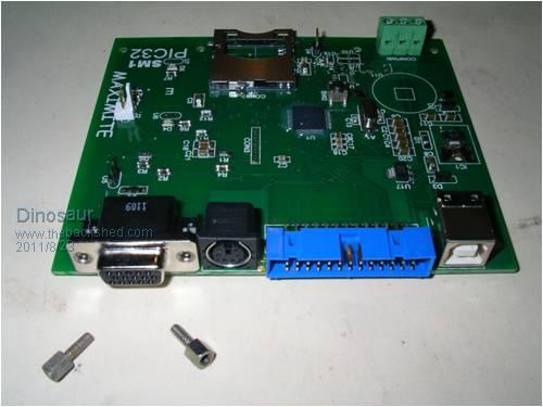

The board that arrived last week does not seem to agree with the circuit on Geoff's site. Are there updates ? I am using it with power from the usb, but have just started looking at using a power supply, and confirming the pin numbers on the ribbon.
According to the circuit, I should have 5 vdc on pin 23 and 3.3 vdc on pin 24, but I can't make sense of the voltages. I am using a standard keyed Ribbon connector pre-made for printer port (DB 25).Pin 1 (red Line) agrees with Ribbon supplied.
I do have to comment on what was suplied, as it is disappointing that:
1. No Vga pillar nuts to screw the vga in tight.
2. Not even a photo-copied sheet detailing the Jumpers.(particularly since I can't find JP1 to select the power source)
The board is marked SM1 PIC32.

Re your query on the nuts, if you have a look at both pictures at the bottom of the page linked to above, you will see the nuts soldered through the board.
If yours hasn't got them, then it is a manufacturing problem, which we will address for you.
Can you take a quick picture of the missing nuts possibly, so we can make sure that this is what has taken place?

Don, the circuit refers to JP1 being used to select usb or external power.
I can't find it.
Will try to enclose photo, with the missing pillar nuts in front.

Thanks for the picture, I can clearly see what you are saying now.

I just had a look at three notebooks and none of them have a VGA cable securing method at all.
I am running on a fast Core i7 notebook as my main PC these days, and it has no provision for securing screws.
Don, I have never based my performance on the performance of others, so the above comment does not make it right. I have seen to many screens / boards go south as a result of spiking on a loose vga connector.
But hey, this was meant as a suggestion, so I'll leave it at that.
