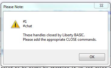

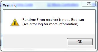

just tried the MMedit and tried to be nasty by starting it up and going straight to 'Connect to Maximite' without a MM connected and got ...
1st window
OK ed then got 2nd window
Yeah I know I shouldn't be using it like that but I had to see what would happen.
Next I'll trying using it properly ... I like the idea though .. let you know how it goes.

Have connected my MaxiMite using USB and followed your instructions and still get the same messages as above.
Over to you!
Keith

Firstly, I am very sorry (and embarrassed) for the errors in the MMedit install.
The program was looking for a configuration setting file that wasn’t there!
The updated program now should behave correctly if the setting file is not found.
To fix the mess I have made:
Make sure that MMedit is not still running in the background either by looking for MMedit.exe with Task Manager and stopping the process or rebooting windows.
Download and install the new version.
You don’t have to uninstall the old version first but if you do go that way, make sure MMedit is not still running first.
Once again, my sincerest apologies for the stuff-up.
I usually get a friend or two to test the installation on a clean PC, but as none of them have a Maximite, I skipped that important step in debugging the install package.
Because I was doing upgrades on my own PC, the missing file was already there.
Please give it another chance.
