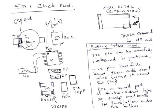

haiqu
Joined: 30/07/2011
Posts: 152
Posted: 10:11am 29 Aug 2011
Rather than include instructions on paper, I'm uploading them here for anyone to use:

haiqu
Joined: 30/07/2011
Posts: 152
Posted: 03:54pm 31 Aug 2011
For those who are about to receive parts kits:
The 10pF capacitor is marked with a black texta so you can tell which one it is. They looked so similar to the 100nF caps that I had to distinguish it somehow.

haiqu
Joined: 30/07/2011
Posts: 152
Posted: 10:06pm 01 Sep 2011
Oh yeah, and if you go back one page there's a layout of the parts on this thread that I posted a few days ago, just in case you happened to miss it.
