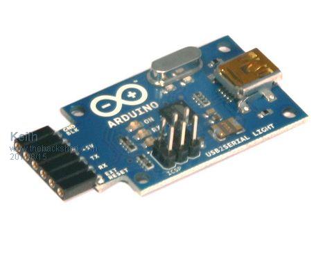

Can anyone tell me if this is useable on the Maximite .... a USB to Serial Converter
www.coolcomponents.co.uk/catalog/product_info.php?cPath=50_7 4&products_id=761&osCsid=93413e9d8a2642cd27a72c3426a1a2bb
Keith
The more we know, the more we know we don't know !

Keith @
Joined: 19/06/2011
Posts: 167
Posted: 04:29am 15 Aug 2011
Sorrrry about the link
try this one

Posted: 04:42am 15 Aug 2011
copied details ... second link appears ok but still getting 404 error?
Arduino USB to Serial Converter
Stock Code : 000761
LIVE - 3 units currently available
This board converts a USB connection into 5 volt TX and RX that you can connect straight to the Arduino Mini or other microcontrollers, allowing them to talk to the computer.
It features the ATmega8U2 programmed as a USB-to-serial converter, the same chip found on the Arduino Uno. The USB Serial module has an ISCP interface, allowing you to reprogram the chip when placed in DFU mode.
The pinouts on the connector are compatible with a standard FTDI header.
UK pounds 8.80

Looks nice, but we don't yet have an RS-232 port to connect it to! I did the mods today, will let you know how it goes.

The adapter you showed us attaches to USB on the PC end and an RS-232 port on the Maximite end. It still needs some sort of UART available to function. There's no advantage to using it unless you don't have a real COM port available on the PC.
The PIC32 is capable of acting as a limited USB host (USB-On-The-Go) but doing that is more difficult than finding a pair of UART pins available.
