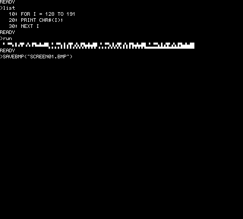

I have attached a modified copy of my DrawChar.c file, which has the graphics characters added.
2011-08-05_193017_DrawChar.zip
Plus a screen shot of how it looks.
