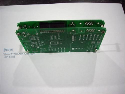

I was wondering if any of the PCB gurus out there could come up with a PCB for
inputs outputs etc that plugs into a Maximite see the Pic.
This PCB is the same size and shape as the current Maximite PCB
with a 26 IDC connector mounted on the bottom in a DIL header if needed to make the height. Then fit a vertical mount 26 pin IDC on the Maximite so two boards can be plugged togther if the user prefers they can use 2 right angle connectors and a ribbon cable.
On the PCB four or so analog inputs set up with resistors for voltage dividers and some bat diodes for protection. ie 2 resistors and 2 diodes per analog input maybe a 3.3 zener just in case (optional). 2 or so pins setup with 1 resistor to +5v for LM35Z temperature sensor use and 2 or 4 depends on space SPDT relays all this comes to the front edge and connected via PCB monuted screw terminals
I am sure we can squeese an RTC in there to
This way we just pick the resitor values and we are ready to measure analog !

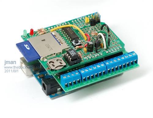

I have add a pic a shield with screw terminals

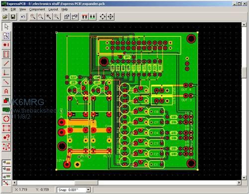

This is a an expander that I have drawn up to have made for my farm gate opener project.
6 digital inputs,
4 digital outputs, 2 relay and 2 transistor switched.
Designed to plug onto the Maximite EV (MINI)
PS. still a work in progress.

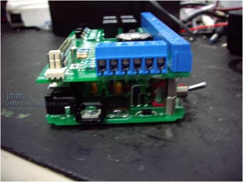

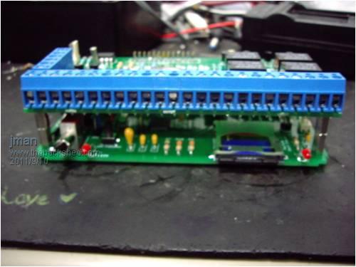

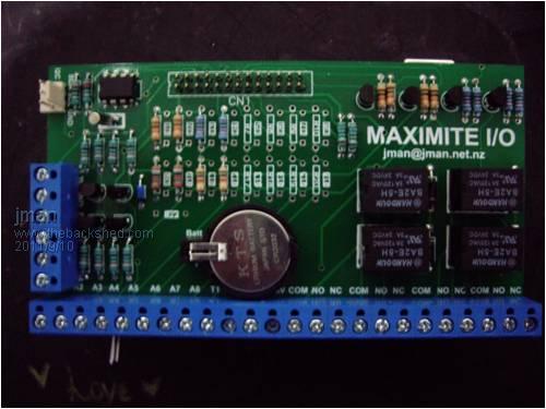

So I got PCB's made for my requirements
This plugs into the Maximite (Header on Maximite is a straight type)
My PCB layout skills are not the best but the boards work ok.
Specs
Real time clock
4 relay outputs
4 Digital inputs (Transistor)
10 Analog inputs 2 of these are setup for LM35 temperature sensors.
Analog has divider just pick resistors to suit your input voltage
I have 2 spare boards with real time clock chips (8563) and crystals should anybody
want one @ around $20 NZD (This is pretty much the cost price)

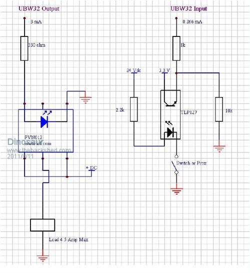

I am interested in buying interface cards for the Maximite or the DuinoMite.
But I cant handle transistor inputs or outputs. They have to be opto's.
Neither do I want to spend the time designing and getting them made.
So, anyone who is contemplating such a design, I am interested.

Dinosaur
Joined: 12/08/2011
Posts: 360
Posted: 05:36am 11 Sep 2011
Hi All
Below a pic of what I use for the UBW32.
There are better options for the Output opto which is a bit slow on the PVN-012
But I have this working reliably on Machines in Geraldton & Mildura.
Hervey Bay Qld.

My concept for a flexible I/O board is to have all of the MM I/O coming out on the board to headers with a range of headers to cross connect to on-board circuit module components like Optos, Relays etc. You just then cross connect what you require. If course some I/O would be dedicated to some purposed e.g. COM1 & would connect to TTL I/O header and also Max232.
I'm a bit neurotic about blowing of the micro chip with strange voltages - hate to try to desolder & resolder it.
