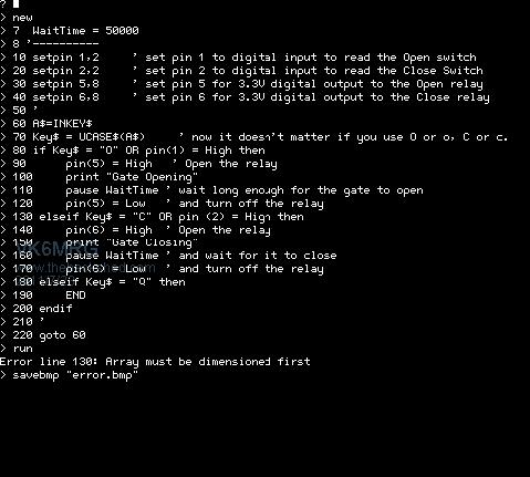

I cut and pasted the program you made up and tried to run it and came up with this error. Any clues.
Its easier to ask forgiveness than to seek permission!
............VK6MRG.............VK3MGR............
James_From_Canb
Joined: 19/06/2011
Posts: 265
Posted: 01:40am 23 Jul 2011
  VK6MRG said   James,
Yep. My bad. Get rid of the space between pin and ( on line 130.

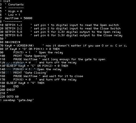

Ok, hear it is so far, Thanks James.
Now I need to add a stop button and stop in the software, so I can type s and stop the program and a switch for gate opened and a switch for gate closed. This is to act as a limit switch, so that if the gate opens faster than normal (battery and solar setup, so if battery is fully charged the actuator will run a bit faster) the limit switch will end the open or closed sequence.
