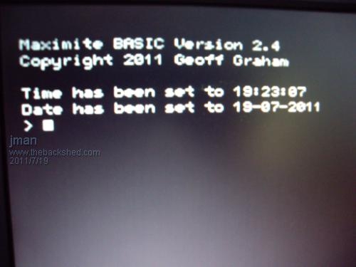

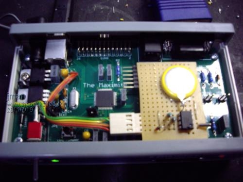

As per the other RTC thread I have managed to get my RTC inside the orginal case.
This really cool as now when I power up the time and date is always correct.
This requires Gerard's I2C firmware
I have included the circuit diagram for reference (straight from the datasheet)
2011-07-19_174444_RTC.zip

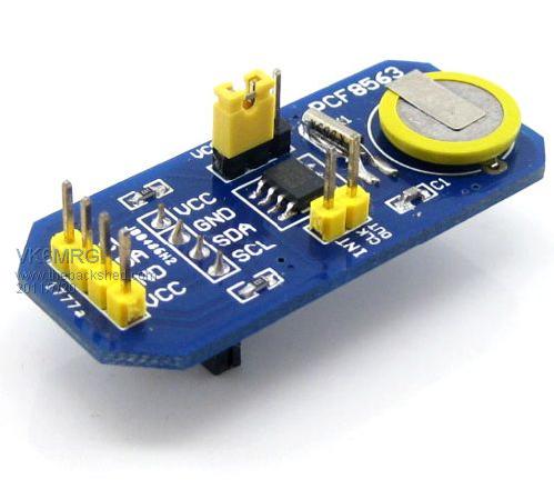

Hi guys,
I thought I'd add my two cents worth about a RTC option.
http://cgi.ebay.com.au/ws/eBayISAPI.dll?ViewItem&item=270741 884749&ssPageName=STRK:MEWAX:IT
I found this on eBay, and should be a straight forward process to integrate into the Maximite.

Posted: 08:05am 20 Jul 2011
  VK6MRG said   Hi guys,
(I think )
Matt
Looks like the listing has been removed
got a new link ?
jman
Joined: 12/06/2011
Posts: 711
Posted: 08:08am 20 Jul 2011
http://www.ebay.com.au/itm/PCF8563-RTC-Board-PCF8563-I2C-int erface-3-3V-battery-/250846999759?pt=LH_DefaultDomain_0&hash =item3a67a574cf
That links works
Looks very good for small price

Posted: 08:18am 20 Jul 2011
Hi Matt
I have ordered one
Once it arrives and I have it working I post the results.

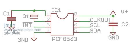

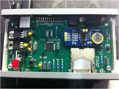

Hi
This device is connected just like any other I2C device
Pin 12 maps to MCU pin 43 (SDA1) and pin 6 on the I/O connector (revised schematic) or pin 21 (original schematic).
Pin 13 maps to MCU pin 44 (SCL1) and pin 8 on the I/O connector (revised schematic) or pin 19 (original schematic).
The PCF8563 has built in pullup resistors to the VCC line so no need for those
You can get +5V from I/O connector pin 23 (revised schematic) or pin 3 (original schematic). A ground will also have to be run to the I2C device (I/O connector pins 1,2,25,26).
This device will also run from 3.3V in that case pin 24 (revised schematic) or pin 4 (original schematic)
Hope this helps
Attached is a circuit diagram ofr the PCF8563

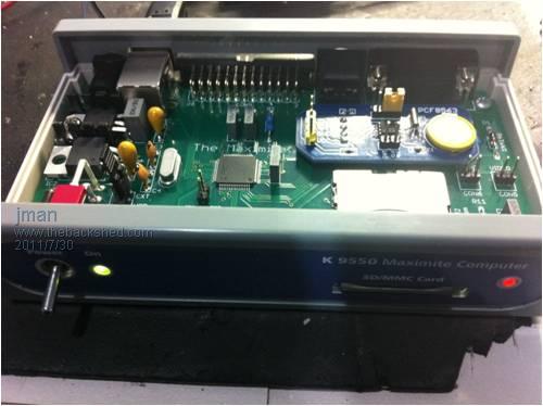

Hi
I have removed the vero board version and installed the PCF8563 Ebay version inside the case
Looks just like a bought one :)
heppy36
Joined: 29/07/2011
Posts: 54
Posted: 09:55pm 29 Jul 2011
Thanks Heaps (Looks like it was made for it)
Heppy

  jman said   Hi
Hi John.
As regards the 5V and 3.3V connections, on the original schematic they were shown on the wrong pins - so 5V is on pin 4 and 3.3V is on pin 3.
regards
