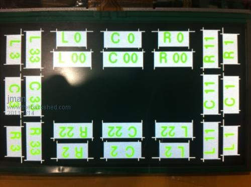

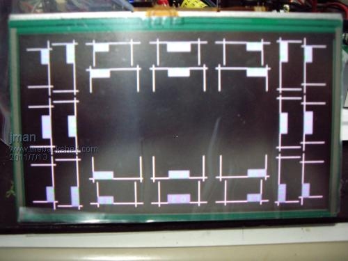

I have attached a pic of the screen running I assume this
the intended pattern ?

Hmm...
The screen is not what I would quite expect - have you loaded your fonts into the TftA?
regards
Gerard

Posted: 10:20am 13 Jul 2011
Nope
Missed that one :)

As you know it is now sorted now my pic looks like yours :)
Thanks again for the help
