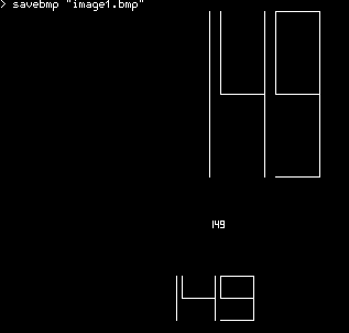

Here's a little routine I wrote this afternoon to display numbers on the screen, 7 segment format, in any size and aspect. I'm writting a little program to display windmill/solar data, and wanted numbers bigger than the standard font size. The future font commands Geoff is adding to the Maximite might make this redundant.

You set the numbers width, height, spacing, etc. The x position is the left edge of the right most number, and the routine will right justify the number. The top few lines are just to increment the number for demo purposes.

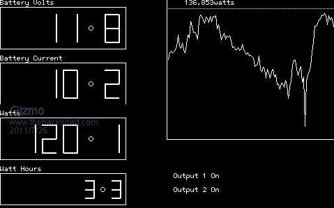

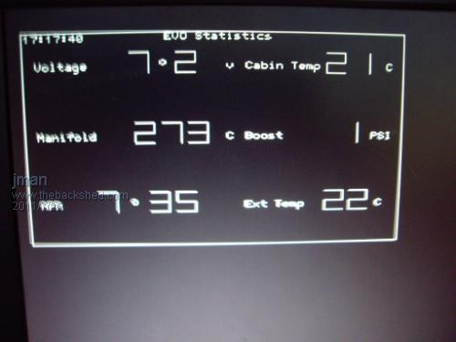

Picture of the work in rogress
Posted: 08:36am 25 Jul 2011
Hi John
Glad to see you worked it out.
This is what I've been using it for.
