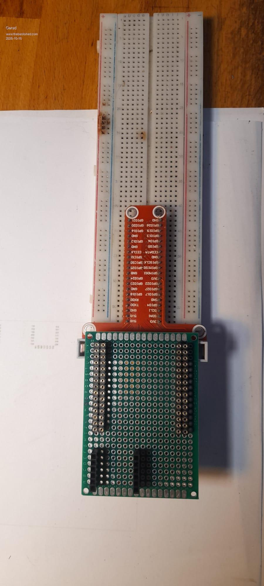

I don’t see the point of fiddling with an adapter when you could just keep it simple  like this:
You could even mount the Pico, with its female headers, on top of a separate board and connect the HDMI jack in parallel beside it. Then you could attach the whole assembly to a breadboard using Nano Tape.

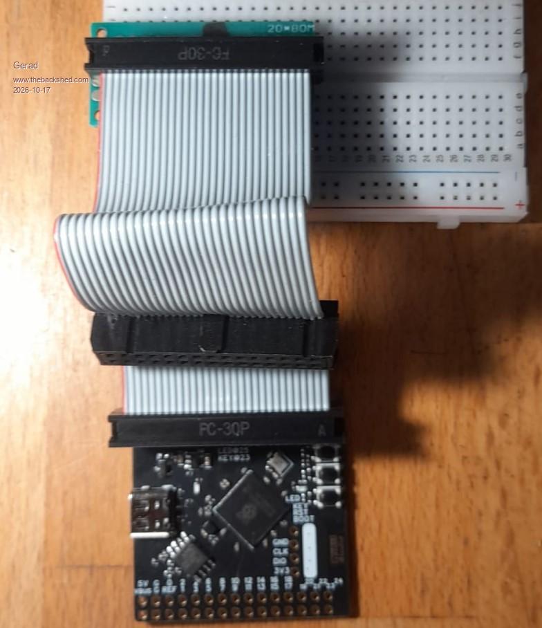

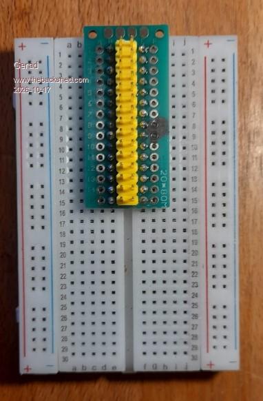

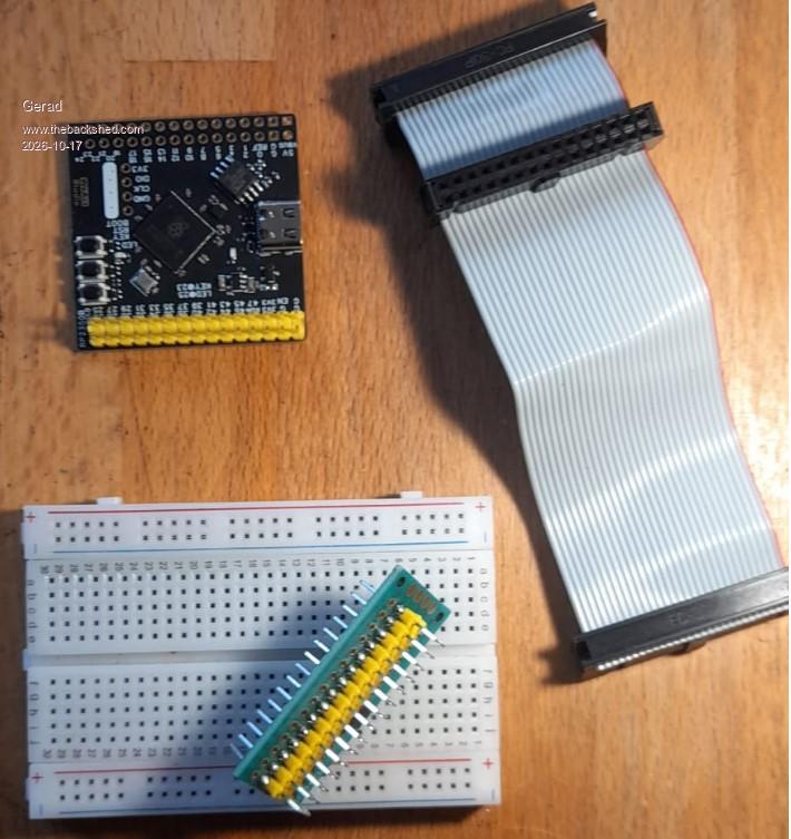

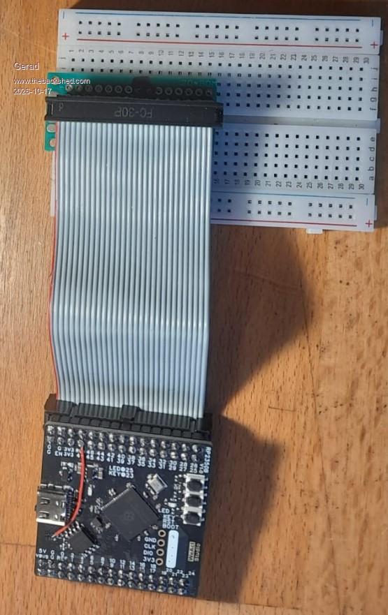

Gerad
Joined: 10/01/2024
Posts: 97
Posted: 03:36pm 16 Oct 2026
WeAct Breadboard Adapter for the Right Side.
