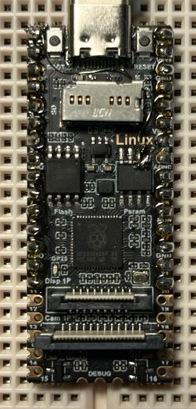

fred777
Joined: 01/07/2021
Posts: 106
Posted: 12:15pm 10 Oct 2026
Bodge done, PSRAM CS is now on GP0. A bit ugly but I'm happy with it
Will add some glue to keep the bodge wire fixed. And I kept GP12-19 free for a HDMI adapter.

Posts: 9328
Posted: 01:19pm 10 Oct 2026
Exactly how I pictured it, but I'd have used yellow wire as I have some and I suspect the electrons like bright colours. :)
Just one point, did you preserve the pullup? If not you may find that you need one.

fred777
Joined: 01/07/2021
Posts: 106
Posted: 01:31pm 10 Oct 2026
No, the pin goes straight to GP0, I did the same with this board, and it didn't seem to matter. Perhaps it could fail in a noisy EMC environment.

ville56
Joined: 08/06/2022
Location: Austria
Posts: 665
Posted: 04:12pm 10 Oct 2026
  fred777 said  No, the pin goes straight to GP0, I did the same with this board, and it didn't seem to matter. Perhaps it could fail in a noisy EMC environment.
Without pullup it may work sometimes, but it is not reliable. There are phases of operation (e.g. booting up) where the CS pin of the PSRAM is floating. Believe me, I made the same error. Ended up that I couldn't even flash a new firmware anymore. Installed the pullup and all issues were gone.

fred777
Joined: 01/07/2021
Posts: 106
Posted: 05:42pm 10 Oct 2026
Ok ok, another bodge
Don't even start about about how ugly this looks - I'm just glad the thing still works.
