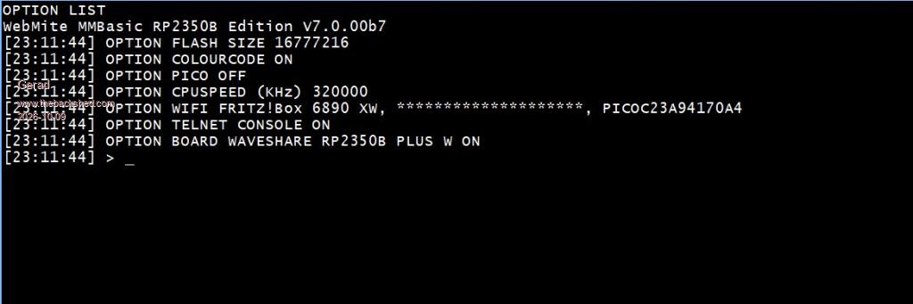

It annoyed me that the “Waveshare RP2350B Plus W” didn't work with Webmite. Now it works with Webmite 6.04.00RC1.
Read The Patch Report
Webmite 6.04.00RC1_WS_only.zip
Patch Report Waveshare RP2350B Plus W.pdf

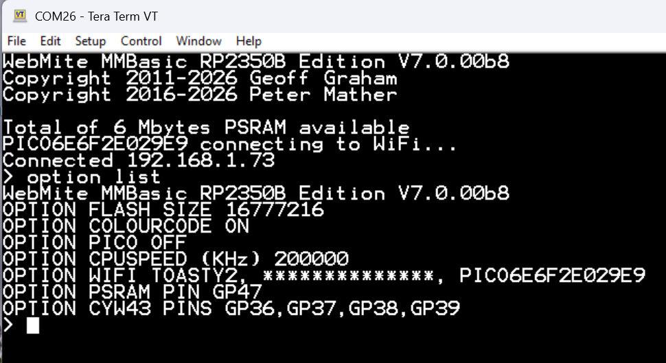

That isn't what I said. It is the concept of board profile that is stupid. It creates the situation where every different board has its own compilation and its own binary - look at the Micropython github for an example of how out of hand this gets. MMbasic does not lock in specific pin configurations it allows the user to specify them in S/W. If the waveshare is to be used properly then this is the correct approach: OPTION CYW43 PINS nn,nn,nn,nn. Otherwise multiple different binaries are needed and that is unsupportable.
Posts: 12172
Posted: 02:16pm 08 Oct 2026
Coming in V7.00.00b8 - Waveshare RP2350B Plus W support as a proper option

Posted: 08:42pm 08 Oct 2026
Yes!!!
Waveshare users are going to love this. With a little soldering, all the pins are accessible.

Posted: 09:23pm 08 Oct 2026
Perfect. Then I can throw this patch away.
