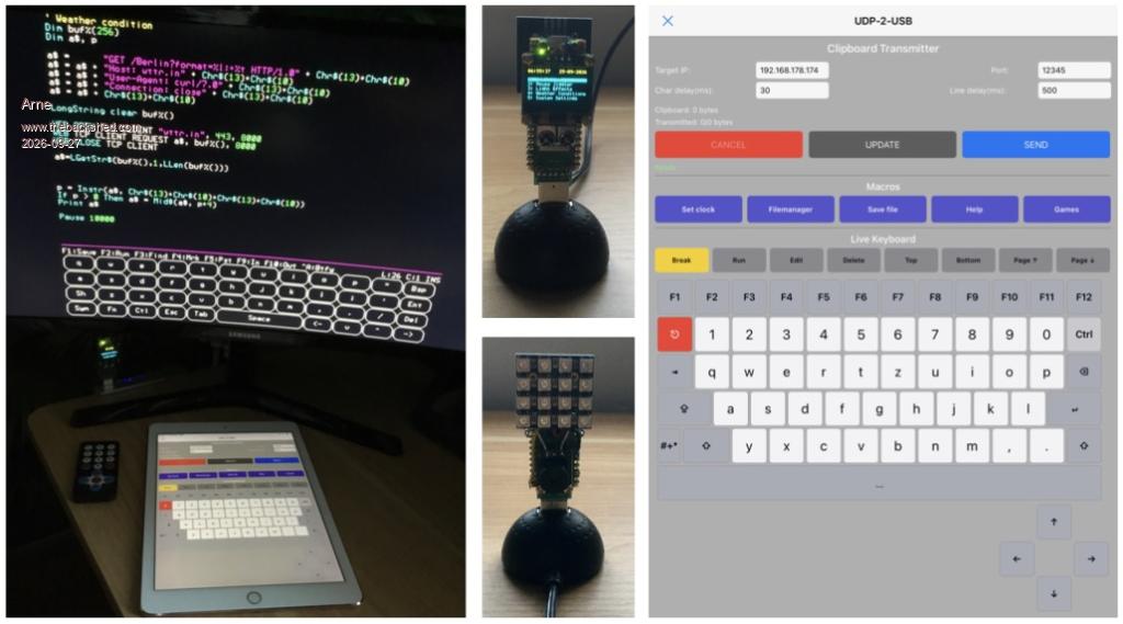

Here a use case:
My second prototype(Injector-stick) combines a RP2040 and a Pico W. On the RP2040 the HID injector firmware is installed, control is performed via the Pico W with MMBasic thru an I2C interface.Basically I use this combination to transfer text data wirelessly via UDP from my iPad to any USB-Picomite. For this purposes a Pythonista script is installed on the iPad. It allows to transfer clipboard data, and can act as a keyboard and macro-pad.
The iPad / Injector-stick combination can also be used direct on any equipment with USB-port (PC/Mac etc).  No additional drivers are needed.
For further information to HID-injector see "Help.txt". Please notice that only DE and US keyboard can be simulated.Default is a German keyboard. Thru CDC or the other interfaces of HID-injector it is easy to switch permanent to US keyboard simulation. Between the control commands a pause of 30-60 ms (depend on the speed of data-transfer/receiver/USB-interface; e.g. IR is slower) shall be implemented.
Due to the different functions and interfaces of HID-injector it will be possible to make sophisticated HID-devices with special control and feedback functionalities…
