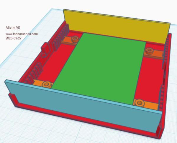

I thought I'd have a go as I now have a mini 3D printer.
Absolute max size 120mm x 120mm x 120mm. The one shown here is 118x114x30 when fully assembled and will just take a full 100x100 pcb.
PCB supports are not moulded in and are printed separately so you have a free choice of where the fixings are. Little vertical supports on the sides will probably be enough to hold them in place, or there's always glue. :) The supports can also hold vertical PCBs or separators to keep the mains stuff away from the low voltage stuff. Due to the maximum bed size of the printer and the fact that I want a 100mm wide PCB screw case fixings aren't great (I tried it) so I'm trying a clip (which I'm working on). Note that the top and bottom of the case are identical. The front and rear panels keep them aligned and the clips hold the top on. The slots for the panels are 2mm wide so work nicely with PCB material.
I need to be very patient with this little printer. It's old and slow (like me). :)

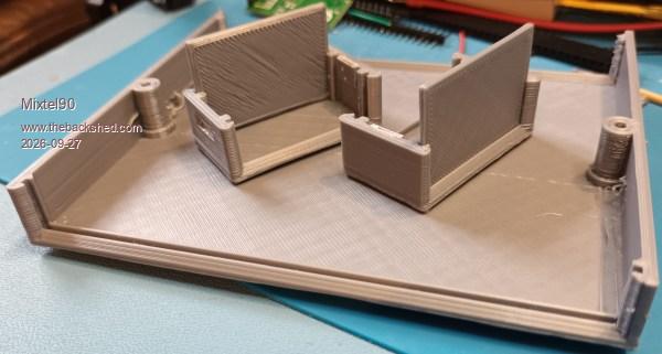

Test pieces
The little case hadn't enough "give" for the clips and they broke off. PLA is quite stiff.

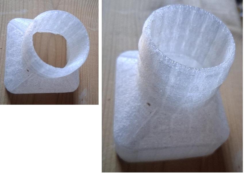

How long did it take to print, Mick? This 50mm x 50mm to 37mm round water diverter connector I had AI design for me took 2+ hours to print at the local library (costing me $2CDN).
Your base looks like it might take 4 hours (not that that matters to me--I could drop it off or maybe even just email them a file).

I don't think I can get the inserts to work on a case that will take a 100mm wide board and will fit onto the bed of my printer. The problem isn't just the box width, it's the width of the "raft" that supports the workpiece. The printing surface is textured and might not work for direct to bed printing. I'd really need something other than that to leave the raft off, I think. It needs experimentation.

I think I've managed to get a printable box that takes a 100x100 board and uses screws to hold the top and bottom together. :)  It's a bit of a tight fit, even with 3mm screws.

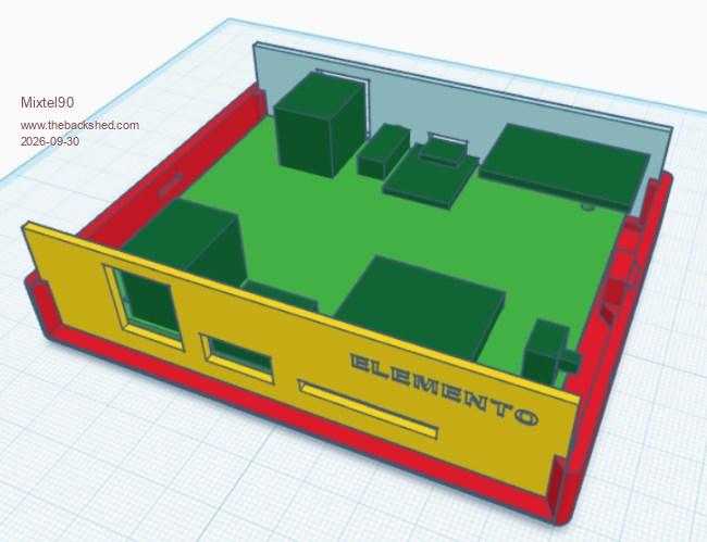

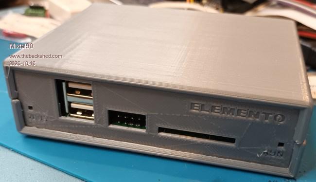

Today I've been sorting out a box for the Elemento. It looks rather nice :)
I'll do one for the PC3x next. It should be easy enough to modify the panels for the PC3 though, it's the same box.
The bed size is still the ruling factor on any box wider than 110mm if  I print using a "raft". The big box half in the picture is 120mm wide and the poor printer was hammering the end stops of the x-axis to print a "raft" 127mm wide (the physical size of the bed). I was quite surprised that it managed it. :)
When the inserts turn up I'll do a test print to see how well they work. I'll also try direct to bed printing at the same time as it doesn't matter if a test print gets mangled.
If anyone wants STL files for these just shout and I'll sort them out.

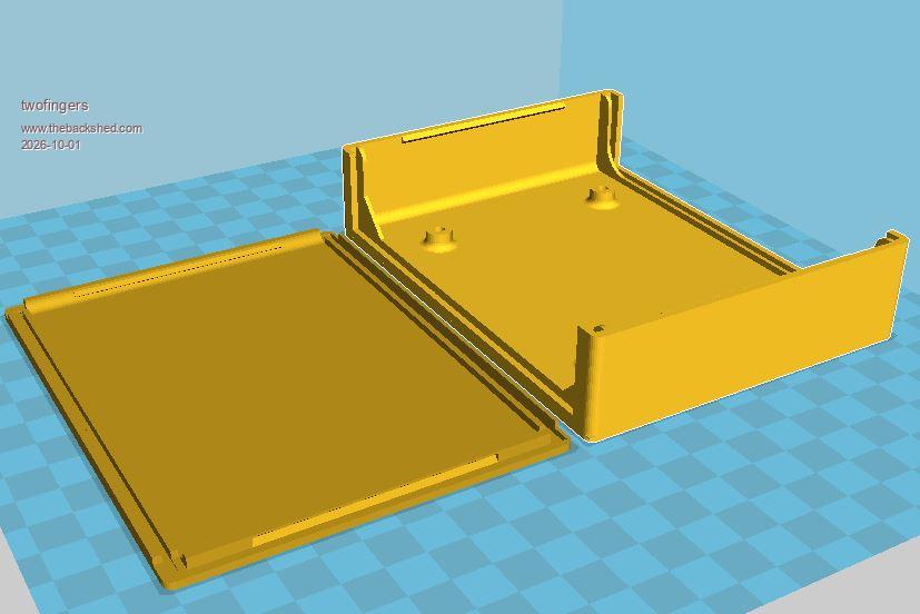

Is it okay with you if I post my own case model in your thread?
Michael

This is my attempt to design an enclosure (in Fusion 360) featuring a screwless lid and interchangeable panels - and not just for PicoMites. However, the lid isn't very secure!
PicoCase MB04.zip
It is designed for use with heat-set inserts.
Michael
