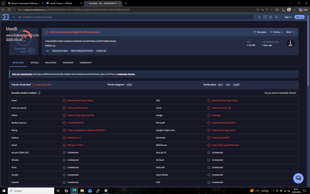

I wanted to update my MMEdit installation from V5.2.9 to the current version and downloaded MMEdit.zip from Geoff's official website.
Windows Defender immediately removed the downloaded ZIP file and reported:
Trojan:Win32/Suschil!rfn
I therefore checked the file with VirusTotal. The result surprised me: 14 out of 60 security vendors currently flag MMEdit.zip as malicious.
The SHA-256 reported by VirusTotal is:
478e2b56f4721db17e42650ce1b4db34c1e61697f3e8c13243f270498c2354a9
The ZIP file is shown as 11.93 MB and was downloaded from:
https://geoffg.net/Downloads/mmedit/MMEdit.zip
I have not overridden the Defender warning or executed anything from the ZIP so far.
Is this a known false positive with the current MMEdit/MMCC version, or could there possibly be a problem with the current download package?
I'm happy to provide screenshots of the Defender and VirusTotal results if useful.

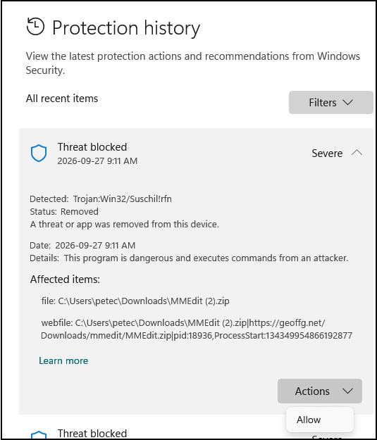

For the sake of science I tried it as well and got the same "virus detected" result (Windows 11).
I opened Windows Security (Just click the windows menu button and type in "Windows Security") and then click on "Protection History". It shows the blocked file.
Click on the blocked file and under "Actions" click "Allow".
Now you can go back to the website and download it without issue.
I think this is important, because in my view, MMEdit is an absolutely critical part of the Maximite Development chain. Not being able to download it would be a tragedy for the mite community.

Thanks Jim, Peter and Pete for testing this.
For the sake of science, I did a few more tests. :-)
I downloaded the original MMEdit.zip again. The SHA-256 is still:
So it is exactly the same file I originally tested.
I then extracted the ZIP and scanned the complete extracted folder with Windows Defender. Just as Jim reported, Defender found no threats.
I also repacked the unchanged files into a new ZIP. Defender was happy with that ZIP as well, although VirusTotal still reported 12/67 detections.
The most interesting result came from testing some of the files separately with VirusTotal:
MMedit5_32_64.exe (installer): 14/71 detections
MMEdit5_XP_portable.zip: 1/55 detections
MMEdit.exe: 1/71 detections
So the majority of the detections seem to be associated with the MMedit5_32_64.exe installer rather than MMEdit.exe itself.
For now I will simply use the portable version and avoid the installer. That works fine for me and I think I've done enough antivirus testing for one weekend. :-)
