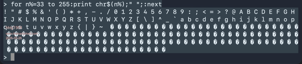

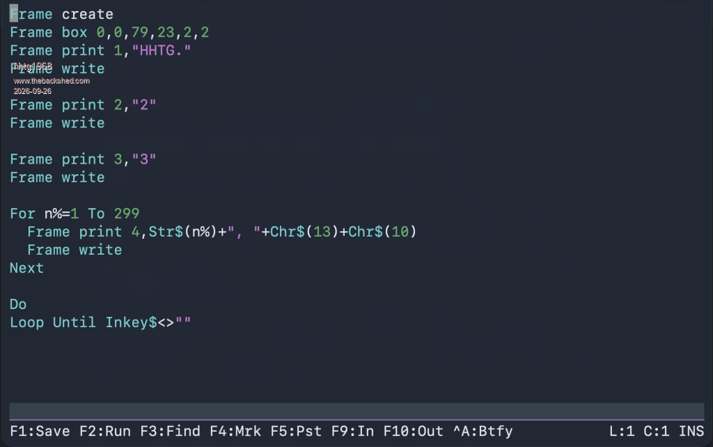

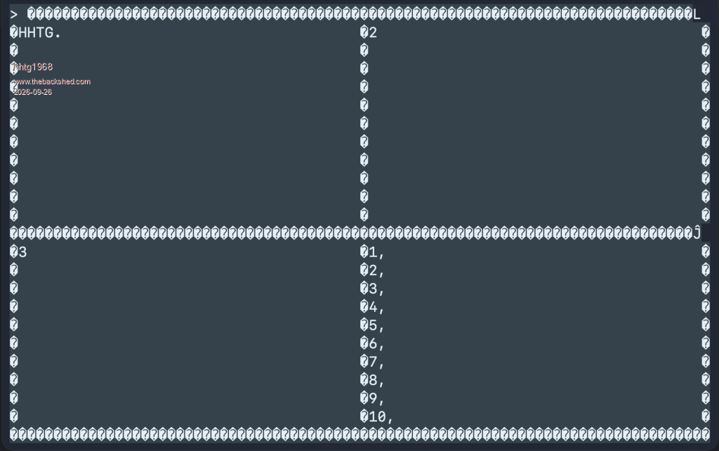

I tested the "frame" commands on my pico2 with rp2350 and mmbasic 6.04.00rc1.
my Shell (z shell (zsh)) on Macos uses the font "SF Mono Terminal". google gemini says this font has the "drawing boxes characters" but my little test program shows strange symbols.
I upload images wich show the .bas-file and the result.
I also upload a picture of a test to print chars 33-255.
half of the chars are strange. is this a problem of ascii or utf-8? I am not a terminal specalist...
where is my mistake?

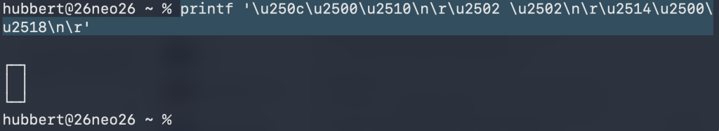

hhtg1968
Joined: 25/05/2023
Posts: 231
Posted: 06:57am 26 Sep 2026
I thought my Shell does not print chars above 7bit (127).
but with printf in the shell i can show a box.
see the image:

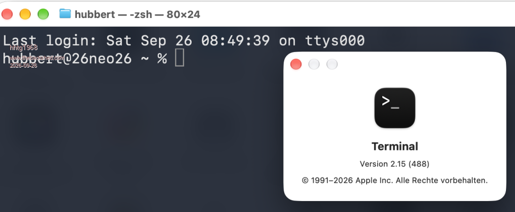

OK, you're using zsh but what terminal program?
Also, what link - USB on the Mac?
Connected with a com port on the Pico or what?
I suspect it's the terminal program not liking whatever the Pico is sending.
hhtg1968
Joined: 25/05/2023
Posts: 231
Posted: 07:15am 26 Sep 2026
  JohnS said  OK, you're using zsh but what terminal program?
I connected the pico via usb to my mac.
I use the standard Terminal App in Macos, look at the picture attached.

The font used on the terminal emulator is not the font that the PicoMite will display, they are independent. The Pico may display correctly on its own LCD, VGA or HDMI display while the terminal emulator shows rubbish because it's not got a font that has the necessary graphic characters (or, indeed, any characters at all) above chr$(127).

MMBasic fonts and teraterm with the correct character set (437) are equivalent for these drawing characters. Anything that appears on the MMbasic screen will be identical on teraterm - that was my testing environment. Whether a MAC can do anything sensible - who knows?
Posts: 4405
Posted: 10:26am 26 Sep 2026
As @TassyJim said it's all about the "code page" being used by your terminal. Hunt around in the terminal preferences, it might be under something like "Compatibility", or "Encoding", or possibly "Obsolete Encoding". You need to select CP437 or strangely enough CP862 (Hebrew) as these contain the box-drawing characters at the expected extended-ASCII values.
Note that there will still be other esoteric MMBasic characters that are not displayed correctly, those require the correct 8-bit bitmap font (CMM2f1.fon) installed and a terminal application capable of using it (TeraTerm on Windows).

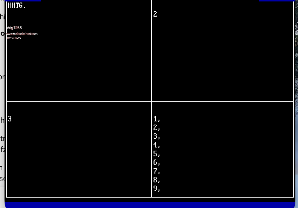

hhtg1968
Joined: 25/05/2023
Posts: 231
Posted: 02:44pm 26 Sep 2026
hello. it depends on the terminal programm. macos does not want to use ascii or code pages, but only utf-8.
I tried several non apple terminal apps. some can use code page 437 an it runs...
have a look at the attached image...
from a programm called "syncterm".

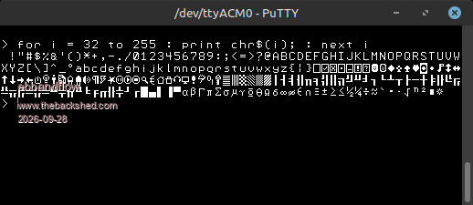

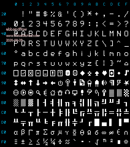

This topic caught my interest. I am also interested in installing a "Picomite Font 1" on my computer so the terminal output matches on-screen text output 1:1. Thanks for bringing it up!
I looked and did not find a suitable font here in the forum (but it may exist?) so I had my assistant    convert the font1.h file into a .ttf font file that should work on Win/Mac/Linux, but so far only tested on Linux Mint using puTTY. Attached is a .zip with the font, a .png of the character map, and the python script used to create the font file.
Let me know if it works out for you? I may post a separate topic for this .zip if it's useful
PicoMiteFont1.zip
Edited 2026-09-28 12:49 by ebbandflow
