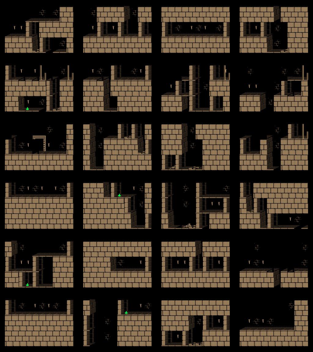

Level 1 screens

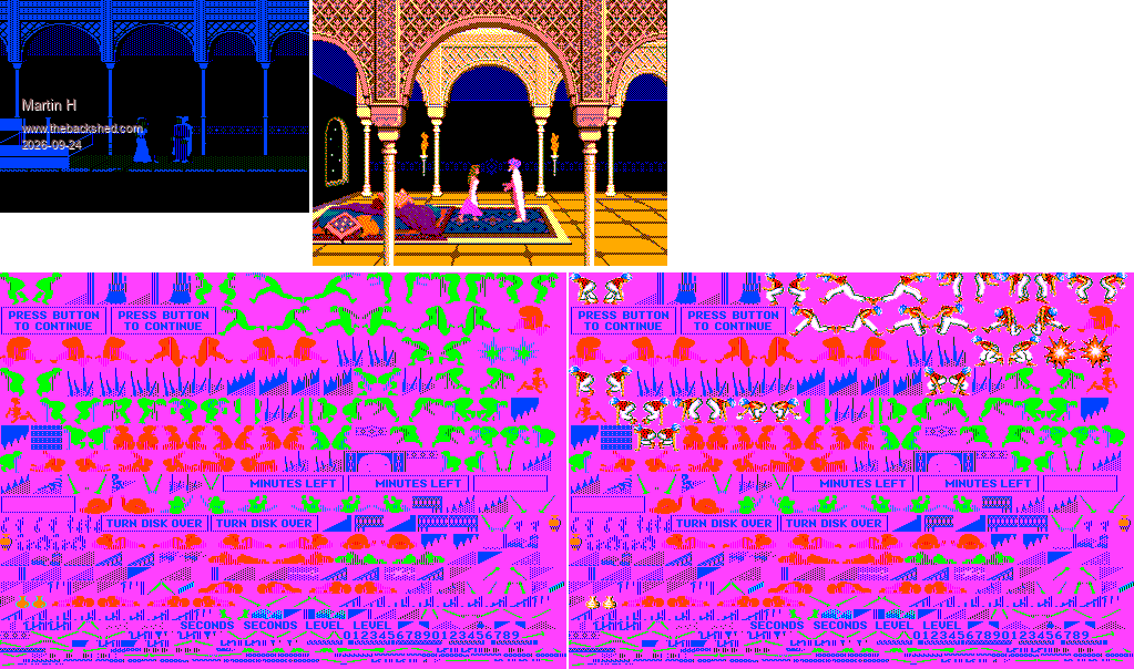

One problem, among others, is that the Apple II generated some of its colors using the NTSC error, which is why some colors are stored as vertical lines in the source files. This results in only half the horizontal resolution and is difficult to convert.
Here are two examples: the Apple graphic and my adaptation:
On the left is CUTROOM.BMP from the Apple II; on the right is my version.
Below that is the sprite sheet “sheet4.bmp,” and next to it is my initial attempt to improve the sprites for RGB 121. I keep the sprites in the same position and at the same size so that no adjustments to the program code are necessary; the only thing that’s omitted is the “MAP” command. The corresponding lines can then be REMed out.
I'm using the Sega Genesis version as a guide, but I'm not just copying the images as they are.
I still have quite a bit of work ahead of me, but I'm already looking forward to the result
Martin

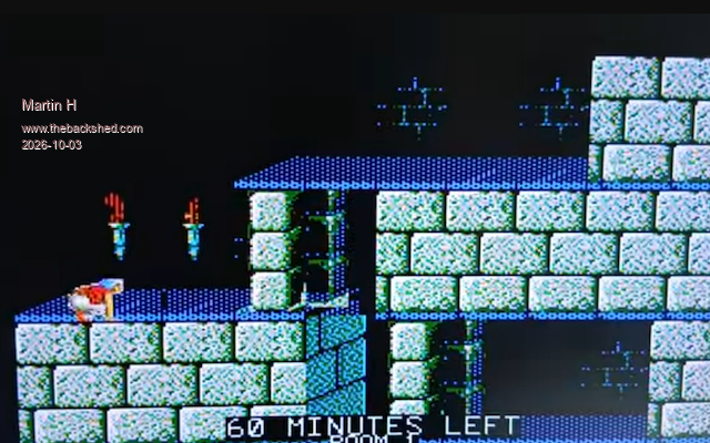

So, here's a quick update:
I've now customized about 90% of the Prince animation sprites and some parts of the environment; next up are the enemies.
The program has been modified so that it no longer executes the MAP commands.
PoPico
cheers
Martin
Edited 2026-10-03 19:34 by Martin H.

Comment out the MAP SET, decrease the player’s sprite-position by 6 pixels (so it does no longer run along the edge of the corridors , as seen in the video)... etc. So just minor adjustments.
The only problem I'm having is that while I can save the Basic file, I can't load it anymore (out of memory). You can see that at the beginning of the video, too... The Pico stores 152,235 bytes. However, the program is only 144 KB (147,456 bytes) long. That just barely fits. If I edit and save it in Notepad++, this “mysterious memory expansion” doesn’t happen.
Now I have to move a few more pixels.
'no comment

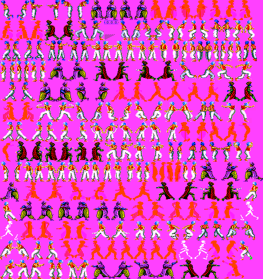

Just so it doesn't look like I'm sitting around doing nothing—it just takes a while
Just as an example—one of four sprite sheets I'm working on at the same time.
 Martin
