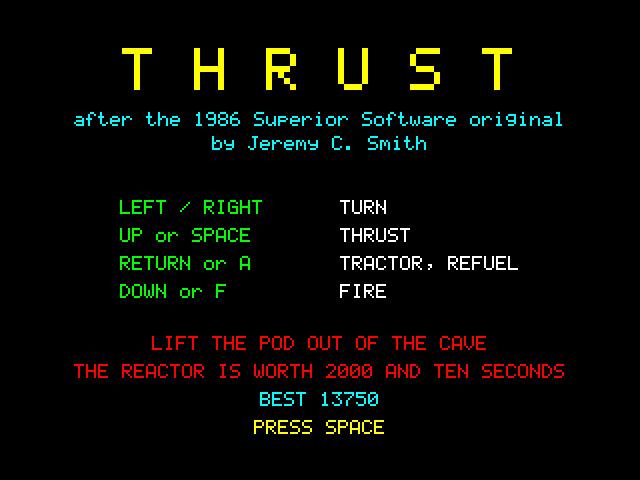

## Controls
| **← →** or **Z X** | turn |
| **↑** or **SPACE** | thrust |
| **RETURN** or **A** | tractor field — also refuels; blocks the gun |
| **↓** or **F** | fire |
| **ESC** | back to the title screen |

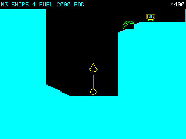

## What you are trying to do
Lift the **Klystron pod** off its stand and carry it up out of the cave.
- Fly down to the pod and **hold RETURN** until the beam appears, then **pull
 away**. The pod lifts off as the line goes taut. It is not a grab — it is a
 tow.
- The pod hangs on a tether and swings. Thrust across the tether sets it
 swinging and thrust along it does not, and a swing does not stop on its own
 — you have to fly it out. Everything you thrust with the pod aboard is at
 half power.
- Fly up out of the top of the cave and the mission is complete.
- **Leaving without the pod costs you a ship.** There is a `NO POD — TURN
 BACK` warning in the panel before you cross the line.
The **reactor** is worth 2000 points. Shoot it fifty times and the planet goes
with it — and you have ten seconds to get clear, counted down in the panel. It
is the difference between a 2000-point mission and a 4000-point one.
Limpet guns are bolted into the rock and shoot at you. They are worth 75 each,
fuel cells 15 if you shoot them instead of drinking them.
Anything touching the rock destroys you — the ship, and the pod you are
towing. There is no landing in Thrust.
