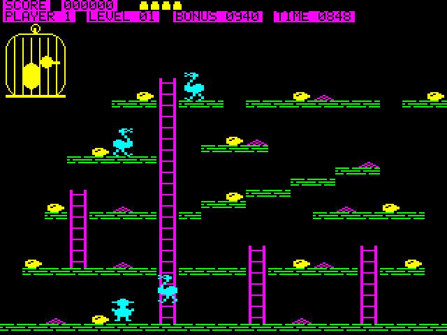

Runs using a local keyboard (USB or PS2). could be modified to use other controls. Tested on the PC3 with both HDMI and VGA builds. May work on a RP2040 (untested).
Please reports any issues with the game play (with corrections if possible)

'  C H U C K I E   E G G        PicoMite MMBasic
'  after the 1983 BBC Micro game by A&F Software
'  Runs in MODE 2 (320 x 240, 16 colours) on VGA and HDMI builds.  MODE 2 is only
'  selected if the screen is not already 320 x 240.
'  Harry has to gather all twelve eggs on each floor before the clock runs
'  out while the hens patrol the girders.  Grain piles are worth points and
'  the hens stop to eat them.
'  The eight floors come round five times over, and each time the odds get
'  worse:
'    levels  1-8   the floor's own hens (3 or 4), duck still caged
'    levels  9-16  no hens at all, but the duck is loose and hunts Harry
'    levels 17-24  the hens are back, and the duck stays out with them
'    levels 25-32  five hens on every floor, plus the duck
'    levels 33-40  five hens and the duck, everything at full speed

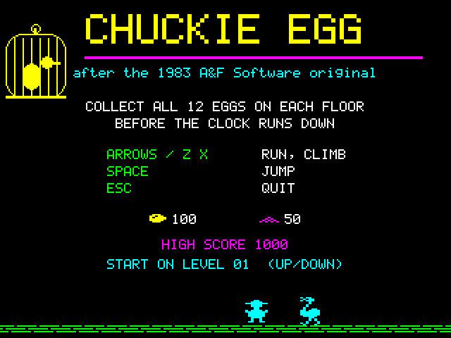

'  Keys      Left / Right ... arrow keys, or Z and X
'            Up / Down ...... arrow keys (ladders)
'            Jump ........... SPACE
'            Quit ........... ESC
'  For testing: UP and DOWN on the title screen pick the level to start
'  on, and N during play skips straight to the next one.
'  How it matches the original
'  The BBC screen is 256 rows: 32 for the status panel and 224 for the
'  floor.  Ours is 240, and the whole 16 row difference comes out of the
'  panel - the BBC set its two text rows in a 32 row band and our 6 x 8
'  font fits the same two rows in 16 - so the playfield keeps its full 224
'  rows.  The BBC is 160 pixels across against our 320, so everything
'  horizontal is doubled and the sprites, girders, ladders and jump arcs
'  come out the same size on screen as they did in 1983.
'  The eight floors were traced from screenshots of the real game; Harry,
'  the hens and the duck are lifted pixel for pixel off its title screen.
'  Sound is synthesised on the PicoMite's square, triangle and noise
'  generators in the style of the original.

SUB DrawWorld
 LOCAL INTEGER r, c, y, fl
 CLS RGB(BLACK)
 ' Where a ladder passes through a girder the BBC draws the ladder alone:
 ' that square is a single tile that you can both climb and stand on, and
 ' no green shows through it.  So the girder is skipped there.
 FOR r = 0 TO GROWS - 1
   y = PLAYTOP + r * CH
   FOR c = 0 TO GCOLS - 1
     fl = grid(r, c)
     IF (fl AND C_LADDER) = 0 AND (fl AND C_SOLID) <> 0 THEN DrawGirder c * CW, y
   NEXT c
 NEXT r
     IF (grid(r, c) AND C_LADDER) <> 0 THEN DrawRungs c * CW, y
   NEXT c
 NEXT r
 IF gLevel <= 8 THEN DrawCage 1 ELSE DrawCage 0
 FOR r = 0 TO nEgg - 1
   IF egOn(r) <> 0 THEN SPRITE WRITE eggBuf, egX(r), egY(r), 0
 NEXT r
 FOR r = 0 TO nSeed - 1
   IF sdOn(r) <> 0 THEN SPRITE WRITE S_SEED, sdX(r), sdY(r), 0
 NEXT r
END SUB

Here is an update:
chuckie.zip
Grain stops the clock. A clockStop counter is set to 20 on pickup and the whole tick — TIME and BONUS — is skipped while it runs down, mirroring .update_timers. It's an assignment, not an addition, so a second pile restarts the pause rather than extending it, exactly as the BBC's STA clock_stop_timer does. 20 ticks is the same 2.2 % of the level clock as the original; Points stay at 50.
Eggs scale with level. 100 × ((level−1) \ 4 + 1), capped at 1000. Verified the formula on the board across all 40 levels — 100 on 1–4, 200 on 5–8, up to 1000 at 37–40, so the cap is reached exactly at the top of the range rather than clipping anything.
Riding a lift into the top costs a life. Previously the lift just wrapped and dropped Harry.
Ladder step-off tolerance implemented, so he can step across from up to 3 px above a girder and gets dropped the last pixel or two. Three rather than two because a climb step is 2 px and a mid-air grab adds a fraction on top.
Edited 2026-09-14 04:18 by matherp
