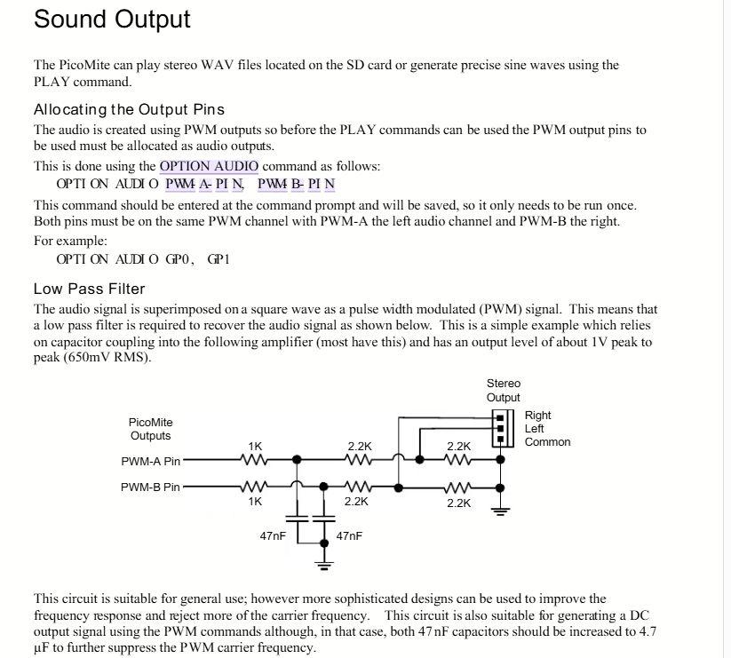

The standard VGA design Uses
option audio gp6,gp7
This outputs pwm audio on these pins. Circuits are plenty on this forum. But just defining this is sufficient to run many games without listening to the sound.
Petscii robots plays MOD files. You also need.
option modbuff enable 192
P.s. You probably have the original silicon chip magazine design, that does not provide audio output.

If you have the early VGA/PS2 board as shown in the PicoMite manual:
As suggested above, it will probably be easier to simply set OPTION AUDIO GP6,GP7 so the PicoMite thinks it has audio and you can run the games until you have the audio circuit built.
The circuit in the manual is suitable for simple sound effects etc using PWM but if you want to play music etc or use an external amp then a DAC is lightyears better. Check out the circuits posted recently under the Home Made Pico Computer 3 threads.
Hope this helps,
Regards, Lyle.

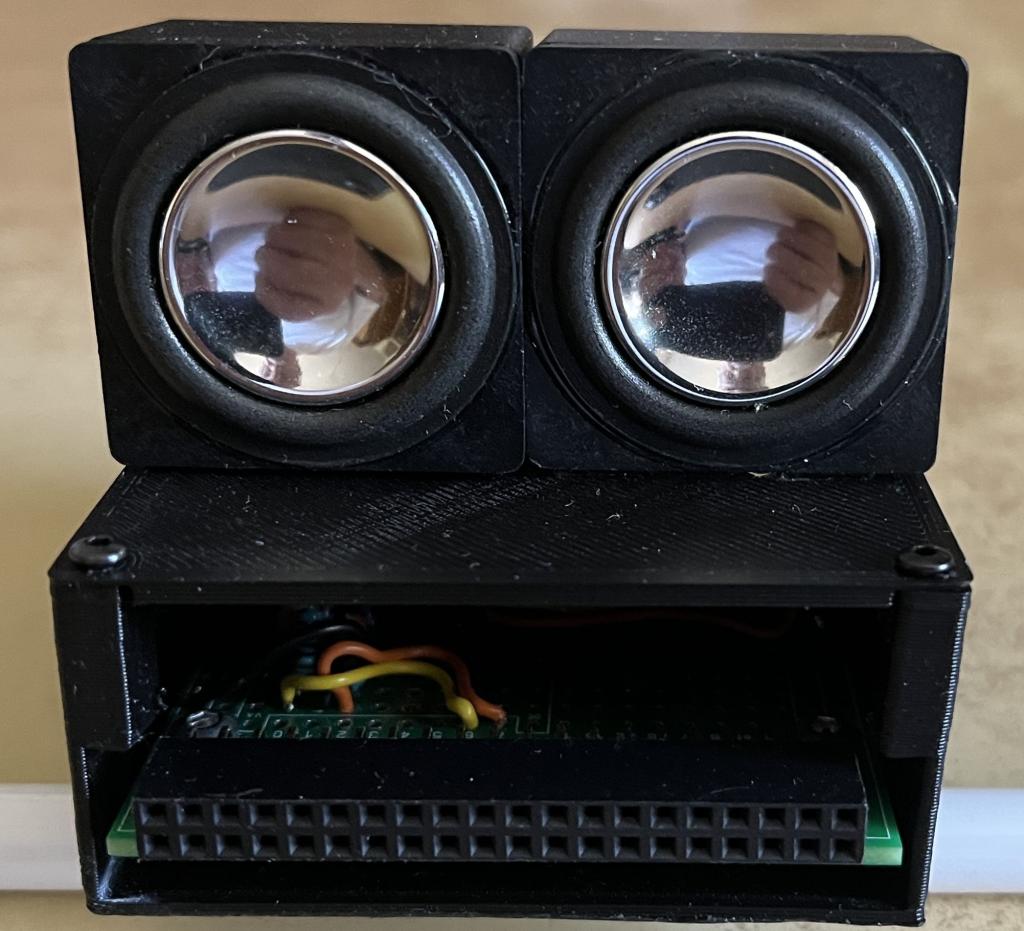

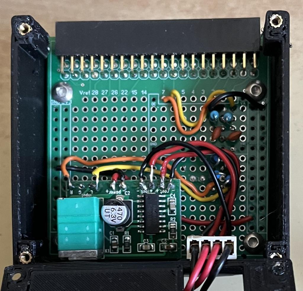

I built a low-pass filter for this PICO board based on instructions from an older manual. You just need four 2.2k resistors, two 1k resistors, and two 47nF capacitors. Here are the instructions:
I use option audio gp6,gp7.
I also bought a small amplifier module from AliExpress for it—search for "PAM8403 5V Power Audio Amplifier Board."
I mounted the whole setup on a perfboard and added two small speakers. I use it for games on the VGA-PICO; FROGGY sounds just like it does in an arcade. I think the sound quality is very good. For playing music, other solutions would certainly be better.
Edited 2026-08-29 19:49 by v.lenzer
Best wishes! Joachim
