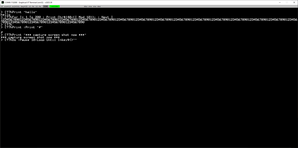

Posted: 11:30pm 28 Aug 2026
  robert.rozee said  however, i would expect you to also still see a ">" either before or after the "[?7h" text. can you please check this?
Before.  Here is an image:

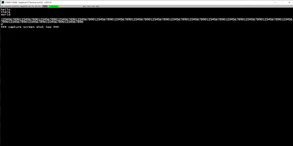

Posted: 03:22am 29 Aug 2026
hi Graeme,
   do you ever see "[?7l"appear? ie, with an "l" (lowercase L) instead of an "h".
i'm trying to figure out what Peter is trying to accomplish by adding in these escape sequences all over the place. try running the following test program (screen size set to 80x24), capturing screen shots where prompted and post the two captured images:
Const ESC=Chr$(27)
Print ESC "[2J" ESC "[1;1H";
Print "hello"
Print "there"
Print "world"
Print
For I= 1 To 200
Print Chr$(48+(I Mod 10));
Next I
Print :Print "#"
Print "*** capture screen shot now ***"
Do :Pause 10:Loop Until Inkey$<>""
Do :Pause 10:Loop While Inkey$<>""
For I=1 To 250
If I<=50 Then Print Else Print Chr$(48+(I Mod 10));
Next I
Print : Print "#"
Print "*** capture another screen shot ***"
Print
End
if you can, perhaps then try running using TeraTerm as the terminal emulator.
if Peter is just sending ESC "[?7h" sequences (AutoWrap ON), then i can safely discard them as GFXterm is already hardwired into that mode. but if he is sending AutoWrap OFF sequences sometimes, that makes life much more complicated for me.
rob   :-)

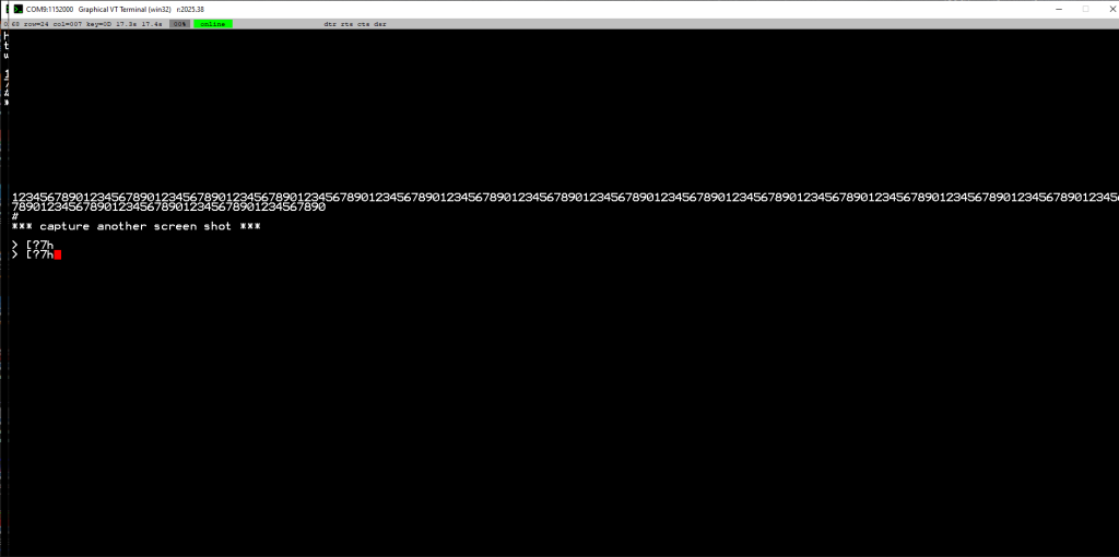

Posts: 3429
Posted: 03:57am 29 Aug 2026
Entered your program segments at the GFXterm command line (putting loops in one line).
Only "[?7h" sequences appear. No "[?7l" appear.
On Win10
In TeraTerm output is the same but without "[?7h" sequences.
Edit

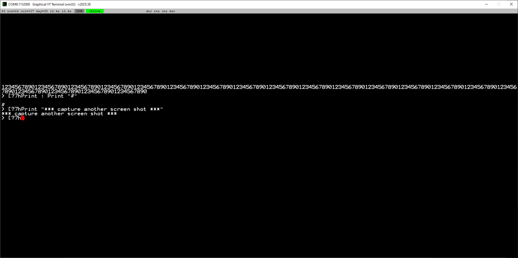

Loading the whole program changes things.
This image was pasted over the previous one and was displaced a little so ignore the column of characters on the left.
Edited 2026-08-29 15:26 by phil99

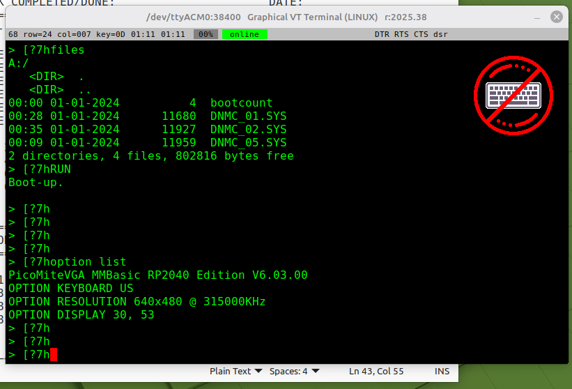

Posted: 07:36am 29 Aug 2026
G'day,
The esc[?7h was introduced at V6.03.00RC0 or RC2, it is sent at every line at the command prompt but not from within a program if using print etc.
The starting sequence entering the editor with V6.03.01 is:
[?1000h[?7l7
and on exit is:
[?1000l[?7h8[?25h> [?7h
and on every line after:
> [?7h
> [?7h
> [?7h
> [?7h
I had a simple terminal program written and this caused me some headaches until I figured it out.
If talking to a PicoMite via the CDC channel this may need to be accounted for.
