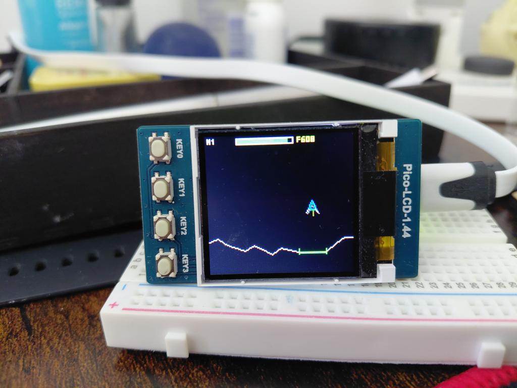

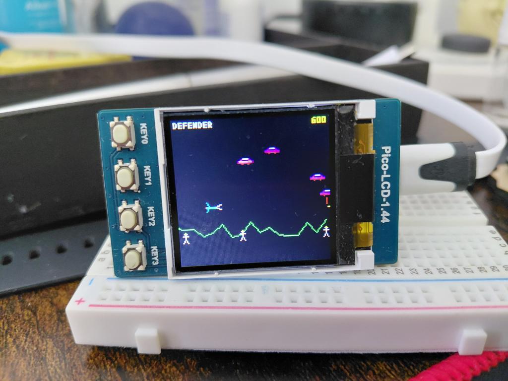

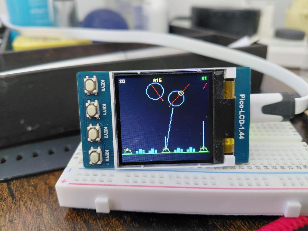

I am coding an "attractor" mode for a static display - which cycles through demos of various games I have written (think Defener, Missile Command etc)  [Will post those else where).
The idea is to leave the screen running, boot the Picomite, select a game and play portion of the game, reboot and then pickanother -- this is then left on to cycle randomly though the games.
