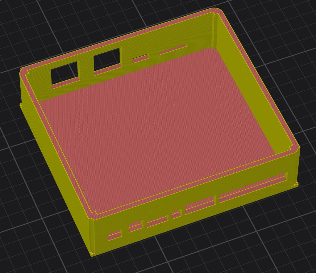

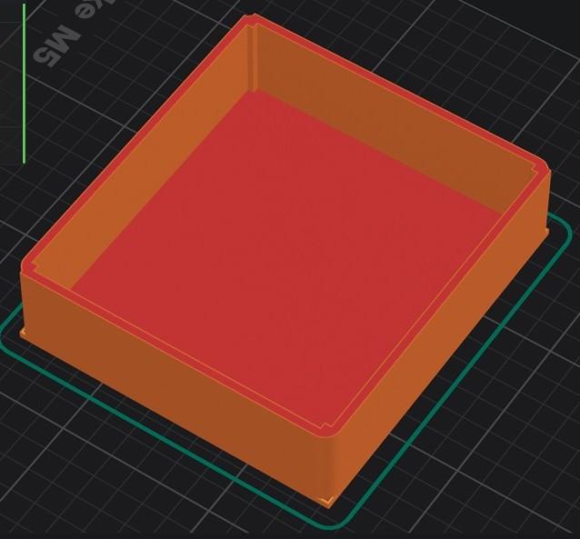

Andrew_G
Joined: 18/10/2016
Posts: 917
Posted: 02:56am 14 Aug 2026
Hi Bryan,
My printer uses 'eufyMake Studio' which is based on 'PrusaSlicer'.
It imported your .stl with no problems. The attached image is what my machine would have printed. Notice the 'effect' on the corners:
- The base is still square but above it is rounded.
- There are also square intrusions into the interior.
Cheers,
Andrew
Bryan1
Joined: 22/02/2006
Posts: 2298
Posted: 03:03am 14 Aug 2026
Hi Andrew thanks for doing that now I did get on and put all the holes in where I measured off the pico 3 box with my trusty 6" ruler and manually entered the data in. Now there was a problem with extrude on the XZ plane so got that fixed and I will have a look on my Flash Forge software to see how it looks. Just got the top to finish for the lid closure then it will time to start drawing up the lid.
After the next update I can put that STL up so you can have a look

Posted: 04:29am 14 Aug 2026
ok got the box finished and yes those 2mm radius's are still there on the base as I kept forgetting to update the base. Now to get on and draw up the lid then the PICO 3 Case can be updated

Andrew_G
Joined: 18/10/2016
Posts: 917
Posted: 11:08pm 14 Aug 2026
Hi Bryan,
The effects are still in the corners,
Andrew
Bryan1
Joined: 22/02/2006
Posts: 2298
Posted: 01:51am 15 Aug 2026
Hi Andrew yes it seems Claude had stuffed up the 'radius' function and it is quite clear as only 1 corner has the right radius also that standoff function has to go to stop those inlays in the inside corners.
