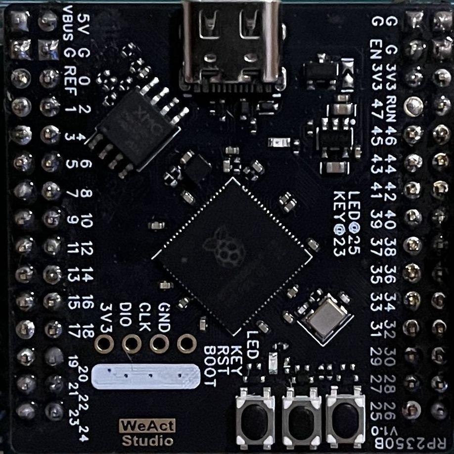

I have a WeAct board with an RP2350B. I soldered a PSRAM chip onto the board, which is addressed via GP47. Previously, MMBasic V6.03.00 was installed, and I was able to run programs on it. Now I want to flash V6.03.01, but I haven't succeeded because the board won't boot. I’ve already tried all the tips found online (press and hold BOOT, connect USB-C, press RESET, release RESET, release BOOT). However, the board does not appear as a drive on my PC. I can rule out the cable as the source of the problem, as I successfully used it to flash other identical boards. The board that won't flash still connects to the terminal without issues, so it isn't defective. I can also rule out the PC, since I was able to flash all the other WeAct RP2350B boards using it. The only difference is that one board has PSRAM connected to GP0, while the others have no PSRAM.
Does anyone have any advice on how I can still flash this board?

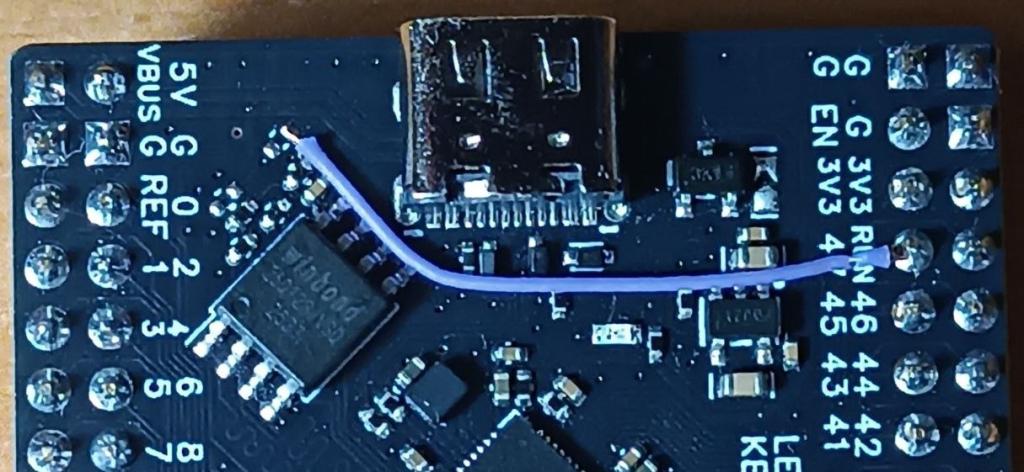

I simply bent Pin 1 of the PSRAM upwards and soldered a short wire to it. I connected the other end to GP47. I haven't soldered in the capacitor (yet).
Unfortunately, the resistor markings on the board are illegible even under a microscope, so I couldn't locate a jumper (0-ohm resistor).
However, I did measure a direct connection between GP0 and Pin 1 of the footprint. Since the pin on the PSRAM is bent up, though, it should work if you just connect Pin 1 to GP47.
I hope we're talking about the same board. Mine is this one:
Best wishes! Joachim

That’s where the problem lies.
If you disconnect pin 1 from the board, the CS pin floats because the pull-up is no longer connected.
Leave pin 1 connected to the board, locate resistor R14 (0Ω), remove it, and install just the wire instead.
Jan.

Posted: 10:56pm 06 Aug 2026
Peter, you're right. I removed the connection to GP47 and connected the PSRAM's CS to GP0. Now the RP2350B boots up again. Thanks for the tip.

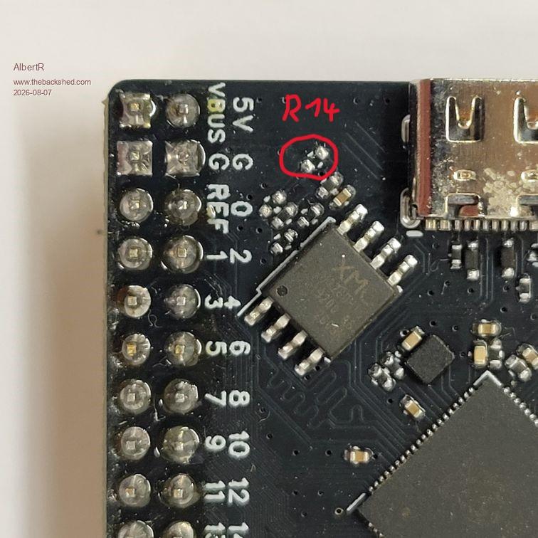

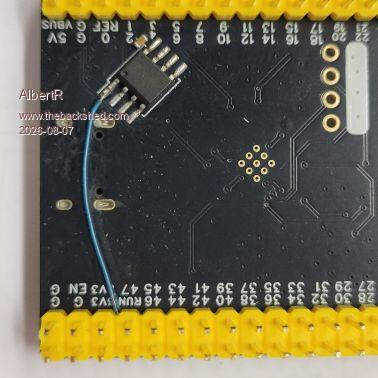

Posted: 08:18am 07 Aug 2026
v.lenzer
  Quote  Unfortunately, the resistor markings on the board are illegible even under a microscope, so I couldn't locate a jumper (0-ohm resistor).
I had identified it using the DMM
I wasn't sure if it would work because of the length of the wire.
But so far, everything seems to be working fine, even at 378 MHz.
Is there perhaps a program I can use to test it that puts a bit of a load on the memory?
Albert

Simply type "Memory" into the console. It will then show you 6 MB of RAM. You should also be able to flash MMBasic using this method.
I assume you removed R14, right?

JanVolk
Joined: 28/01/2023
Posts: 420
Posted: 03:29pm 08 Aug 2026
javavi,
Also a great solution for when the pins are already in place but there isn't much room for solder pads.
I used 0.32 mm enameled copper wire and secured it with superglue.
Now I just need to mount the assembly onto a perfboard and add a few other components for testing.

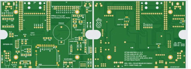

Posted: 05:25pm 08 Aug 2026
  JanVolk said  Now I just need to mount the assembly onto a perfboard and add a few other components for testing.
Don't forget Mick's breakout board for the WeAct RP2350B.
(Though I didn't find this among the PCBs linked on his signature. I may be blind ;-} )

Posted: 06:04pm 08 Aug 2026
The PSRAM isn't on Mick's PCB--it's on the WeAct board and you can do the same mod as shown above.

Posts: 9328
Posted: 06:17pm 08 Aug 2026
Nope, that board isn't on my list. I'm afraid the list is rather out of date. lol
I was never happy with the audio side of that. In fact, I've not really been happy with the I2S modules that I've tried. That may well be my fault.
