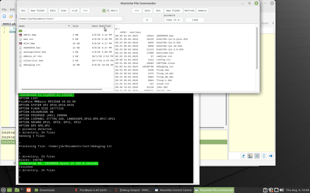

When transferring  large files (10Mbyte) from PC to Pico (V60300) drive B to PC I get "no response found" error messages at irregular locations.
Some times at low block numbers (800 or 3500), sometimes at almost makes it to the end (89000 blocks). On the LCD display it reads "too many errors".

I can transfer 18MB files without any errors so far.

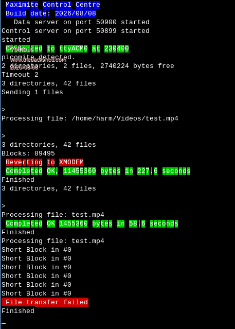

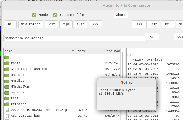

1/ The speed I achieve (on RP2040 GEEK running 200MHz) is 52kbps towards the pico. But that is back to "normal" since that is also roughly what 535/537 achieves.
2/ One problem is that uploading back to the PC, there is in many cases no popup showing progress (see 4). I tried repowering GEEK, restarting MMCC, but there is no progress popup. In the end the file is transferred, but no progress.
3/ On large files, only part of the file is transferred. Exactly 10Mbyte is missing.
As you can see 11455360 bytes are transferred to B drive of pico. But trying to transfer this same file back to the PC indicates 1455360 bytes are transferred. And indeed, the file size on the PC is 1Mbyte (not 10Mbyte).

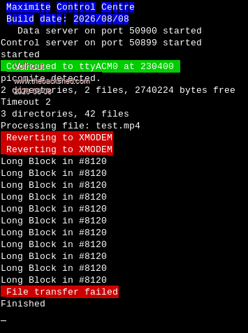

4/ maybe relates to issue 2. Above screenshot is taken on a transfer that disabled YMODEM (to force XMODEM). When you enable YMODEM, there is a double "reverting to XMODEM". The "long block" error messages are because I interrupted the transfer. They normally do not show. You simply get a message saying "finished".
So there is no progress popup on XMODEM when YMODEM is enabled, but XMODEM is selected anyway. But there is a progress popup when YMODEM is disabled.
P.S. speed from pico to PC is 25kbps.

2 issues with filemanager
1/ When a large file (10Mbyte) is written to pico B drive, copying it back to the PC only copies part of it. 1MB in stead of 10MB.
2/ When YMODEM is enabled, and MMCC decides to use XMODEM, there is no progress popup. When YMODEM is disabled, there is a progress indicator with XMODEM transfers.

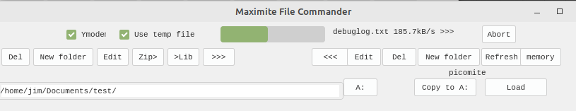

The progress indicator is now a standard progress bar.
Files larger than 10MB now transfer.
I have cleaned up some of the error messages.
Still a lot to do but I hope this is usable.

P.s. the progress indicator is nice!
