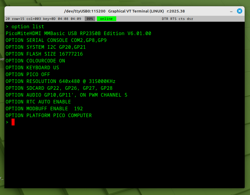

New PM3 all-in-one boards, OPTION RESET PICO COMPUTER 3 command issued at the console, answered Y to the question about "...this will erase everything", waited for it to do its thing, but not getting any HDMI output from the board.
Pressed RESET - no HDMI.
Cycled power - no HDMI.
Console works fine, so I feel I am doing something wrong at my end.
Am I using the most up to date firmware?
Silkscreen says I can use any 2350 FW, but I am wondering if that still means from a certain FW revision number....(and I may not be using it)

I dug out an earlier PICO COMPUTER 2B, and loaded the same FW onto it, and it restarts and the HDMI works fine on it, so I guess I must be doing something wrong with respect to the setup of the new v3 PCB.
My biggest suspect, is that I am not using the latest or correct FW version.
Can someone either link me to the latest version that DOES work with the PM3, or simply post a ZIP file here with the correct uf2 file in it.
Thanks a bunch.

I think you probably need 6.03.00
OPTION RESET PICO COMPUTER 3 possibly looks like it is accepted but probably matches
OPTION RESET PICO COMPUTER in the older firmware.
OPTION RESET LIST should show what is available for the loaded firmware.
