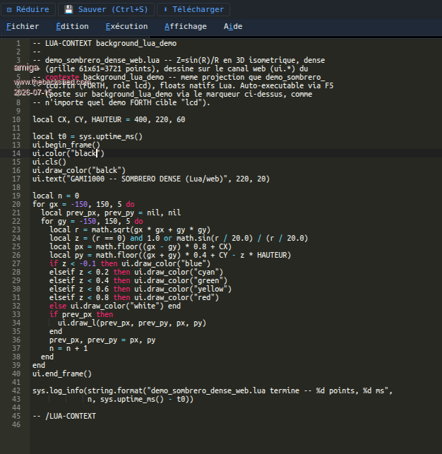

In addition to the 'FORTH' engine—which handles all low-level management transparently to the user , I’ve integrated a 'Lua' interpreter running in its own VM alongside the 'FORTH' engine.
'Lua' utilizes the hardware infrastructure managed by 'FORTH' by using the same protocol as the 'FORTH' engine.
No need to reinvent the wheel.
'Lua' integrates into the IDE just like 'FORTH' does (edit/run/simulation screen) and uses the same components as the 'FORTH' engine.

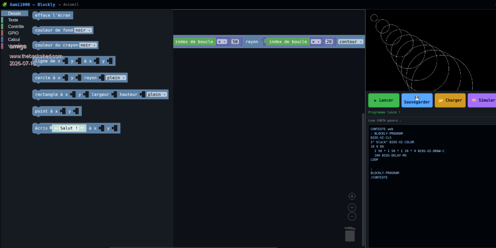

I’ve implemented 'Blockly' similar to 'Scratch'.
It’s a programming learning app for my 7-year-old granddaughter.
I’ve started teaching her the 'FORTH' stack philosophy... we had a lot of fun using actual plates!

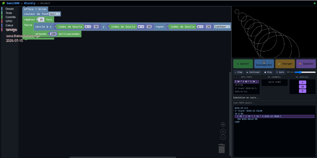

Currently, 'Blockly' generates 'FORTH' code that runs on the simulation screen just like a real 'FORTH' script; 'LCD' screen control is currently being implemented.

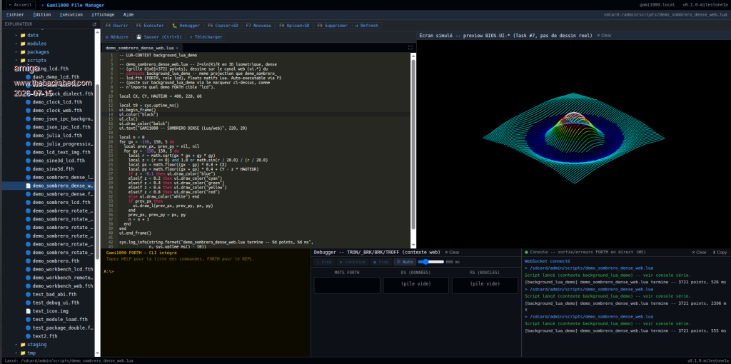

Here are a few screenshots...

'Sombrero' coded with 'Lua' and execute in 'P4' with 'Lua' engine
'Sombrero' 'Lua' code .
'Blockly' embedded in 'P4'.
'Blockly' generate 'FORTH' code ,run it throught 'VM-FORTH' and debug with dynamic display stack's FORTH
