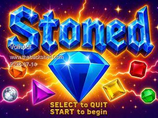

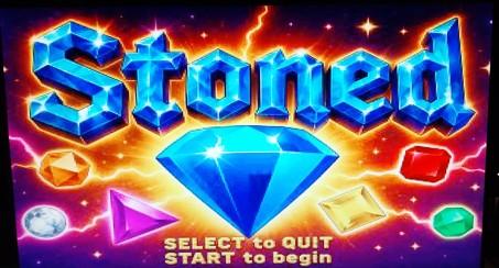

In this game you gave to move gems (stones) around to create groups of 3 or more in one line (horizontal or vertical).
You move in the grid with the D-pad, and select a stone to move with A.
SELECT quits to menu, and finally closes the game.
START starts the game.
B provides a hint (just in case you don't see it anymore).
Find the game in below ZIP.
stoned.zip
The controls are for Game*Mite/PicoGamer, but in essence are string based, so it is quite simple to patch the program for mouse or keyboard control.

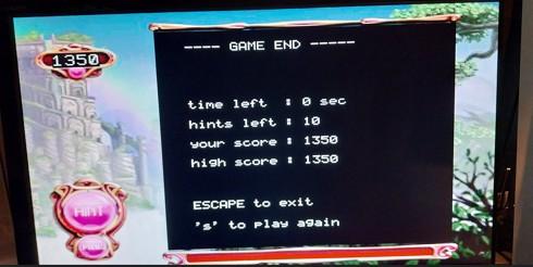

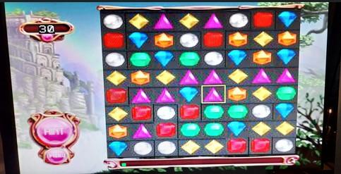

Help requested !
I do not own a 2350 HDMI setup yet. I could use some help from someone who does.
Please install the "stoned.zip" from the first post.
Use add this MMBasic program to the same folder.
stoned_kb.zip
Set the HDMI to OPTION RESOLUTION 640x480 in OPTIONS (I use MODE 4 = 15bit colors, resembling the ILI9341 display).
RUN "stoned_kb.bas"
Start the game with "s", stop with ESCAPE, help menu = ESCAPE
Please report any problems, a screenshot will be appreciated (I can run the game on 2040 VGA, but it looks ugly).
Thanks in advance for the support.
Edited 2026-07-16 19:08 by Volhout

Hi,
I tested it on "PicoMiteHDMIUSBV6.03.00" works just perfect!
Here is a video: Dropbox
P.S.: I just commented out the whole play MOD thing, because I didn't want to allocate memory to play mod, so I didn't tested the playback.
Cool game!
Greetings
Daniel

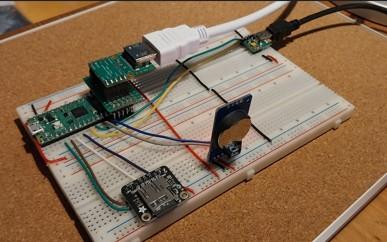

Hello,
Did a quick test, Pico2 HDMI seems to work just fine.
A bit of older firmware installed V6.03.00RC11
PicoMiteHDMI MMBasic USB RP2350A Edition V6.03.00RC11
OPTION SYSTEM I2C GP10,GP11
OPTION FLASH SIZE 4194304
OPTION COLOURCODE ON
OPTION MOUSE SENSITIVITY     1.0000
OPTION KEYBOARD US
OPTION RESOLUTION 640x480 @ 252000KHz
OPTION DISPLAY 30, 53
OPTION SDCARD GP5, GP6, GP4, GP3
OPTION RTC AUTO ENABLE
/Peter63

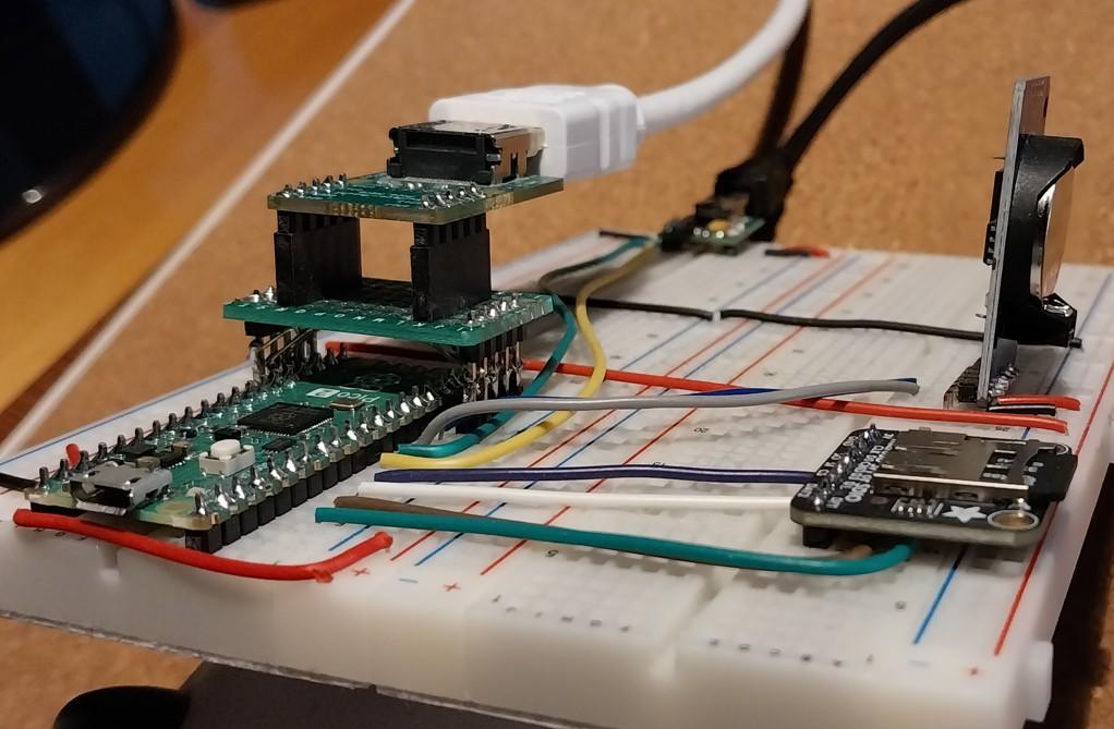

What is that device with cheese wiz on it?

  Quote  What is that device with cheese wiz on it?
breadboard from the side
The HDMI adapter might have ended up a bit unnecessarily tall when I built it.
/Peter63
