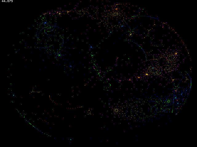

twofingers
Joined: 02/06/2014
Posts: 1785
Posted: 02:12pm 20 Jun 2026
Hi Peter,
Unfortunately, I’m still getting the same error (RC12).
However, the memory pack seems unnecessary to me.
By the way, it would be helpful if you could post the C source code from time to time. Thanks!
Michael
The console shows (still RC12):

Posts: 12173
Posted: 02:20pm 20 Jun 2026
Not having the pack/unpack destroys the colour rendering. What did  the print output show before the crash?
Posts: 12173
Posted: 02:28pm 20 Jun 2026
OK, for some reason the heap isn't aligned on that version. It should be 256 aligned.
unsigned char __attribute__((aligned(256))) AllMemory[HEAP_MEMORY_SIZE + 256 + 320 * 240 * 2];
I assume you are using default 640x480 @315MHz?
