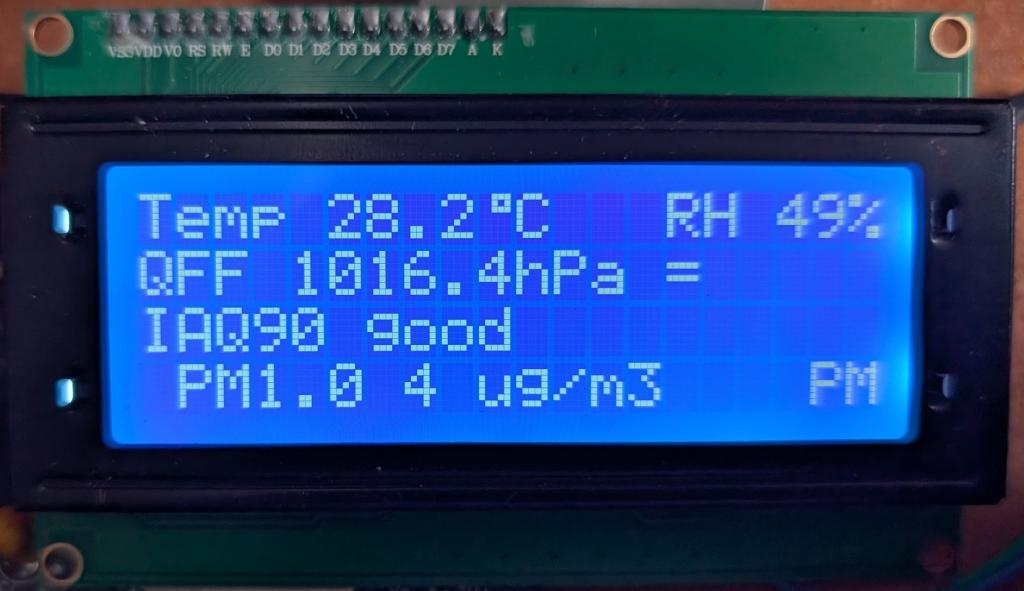

This started off as an exploration of the BME688  and then turned into an air monitor by adding a Plantower PMS5003 particle matter sensor. The particulate information continuously scrolls across the bottom line. The code supports local pressure (QFE), sea level pressure adjusted assuming a standard atmosphere (QNH), and sea level pressure adjusted using the local temperature (QFF). This is configured in lines 31 and 35.
The code should also support the bme680 and bme690 (untested)

LcdLine 1, "Air monitor"
LcdLine 2, "starting..."

     LcdLine 1, "Temp " + STR$(tC, 0, 1) + CHR$(0) + "C   RH " + STR$(rh, 0, 0) + "%"
     LcdLine 2, plabel + STR$(slp, 0, 1) + "hPa " + Trend$(slp - slowref)
     LcdLine 3, l3
     ' PM values + per-size particle counts for the scrolling line
     marquee = "PM1.0 " + STR$(pm1) + " ug/m3    "
     marquee = marquee + "PM2.5 " + STR$(pm25) + " ug/m3    "
     marquee = marquee + "PM10 " + STR$(pm10) + " ug/m3    "
     marquee = marquee + "Counts per 0.1L  "
     marquee = marquee + ">0.3um " + STR$(c03) + "  >0.5um " + STR$(c05) + "  >1.0um " + STR$(c10) + "  "
