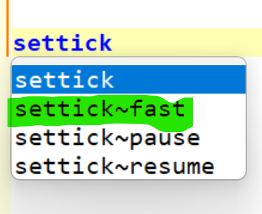

I didn't see
  Quote  SETTICK FAST
Is it a thing?

Posts: 12173
Posted: 12:25pm 16 Jun 2026
base$ is a sort of pseudo command that is used to process hex$, bin$ and oct$. As it happens it will do wacky bases as well but isn't really a standard function.
There is no such thing as settick fast
Posted: 08:17pm 16 Jun 2026
  PhenixRising said  I didn't see
  Quote  SETTICK FAST
Is it a thing?
Only on the CMM2

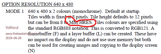

Posts: 6253
Posted: 09:06am 26 Jun 2026
Should be MM.VRES (multiple locations)
