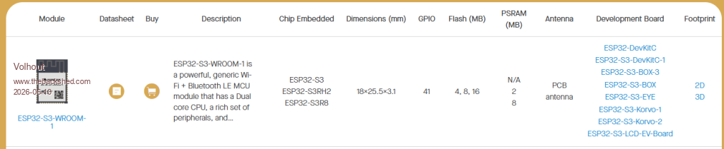

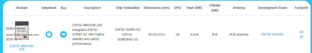

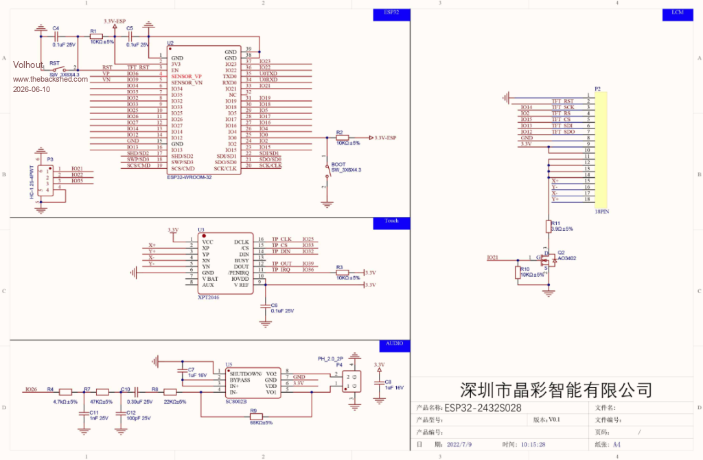

Hi Mick,
Not sure the S3 build will work on the CYD. The CYD uses a different chip.
The S3 chip has a different core.

The CYD I'm using only applies to the "ESP32-2432S028", not to the "ESP32-2432S028R" or other versions. It uses the minimal ESP32 module. Neither have anything like the capability of the S3.
