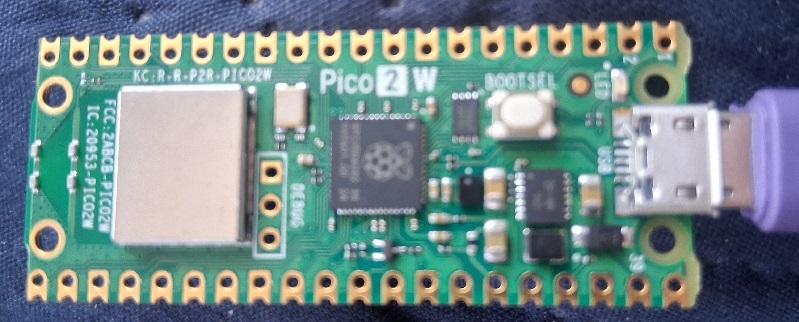

I bought some Pico 2Ws from Adafruit. I'm having trouble trying to flash them. After apparently successful flash, I get:
WebMite MMBasic RP2350A Edition V6.03.00RC14
Copyright 2011-2026 Geoff Graham
Copyright 2016-2026 Peter Mather
Formatting the A: drive
[CYW43] error: hdr mismatch 0c0c ^ fff3
                                      [CYW43] do_ioctl(2, 263, 1008): timeout
                                                                             [CYW43] error: hdr mismatch 0102 ^ feff
                                                                                                                    [CYW43] do_ioctl(2, 263, 10): timeout
                                [CYW43] do_ioctl(0, 262, 20): timeout
                                                                     [CYW43] do_ioctl(2, 263, 20): timeout
I've tried universal_flash_nuke.uf2, but that has not made a difference.

Known issue in recent releases. Will be fixed in the next
UPDATE
Fix in RC15 - just posted

Working now; thanks.
