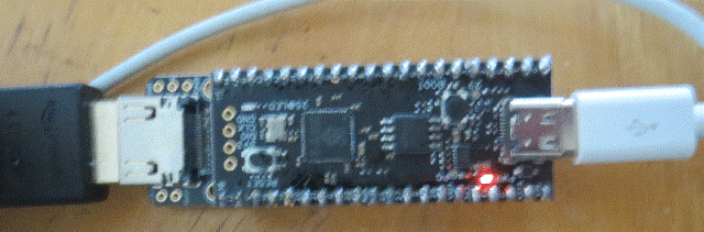

  tgerbic said  I only need ttl console, HDMI and sound out
Hard to beat this HDMI (+DVI) sock: Pico DVI
You'd need to add sound.
