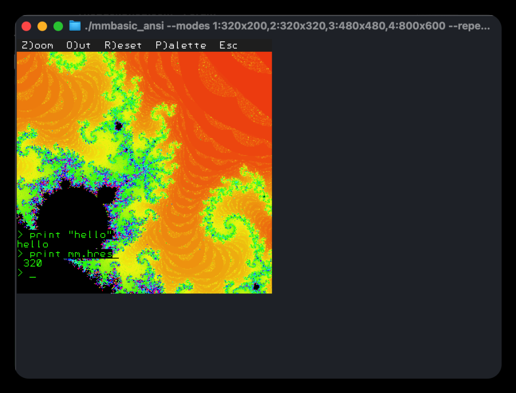

As part of my MMBasic Anywhere work to make MMBasic more portable, I made a version that compiled and ran locally on my mac, for testing purposes. But that was only text mode, which is a bit boring.
So I did something a bit silly and made a version with full graphics mode, in a terminal. It uses half-block rendering, so each text block is two pixels, vertically stacked. This works better in modern terminals, and with a terminal font that's as close as possible to being twice as tall as it is wide. And you have to zoom way out.
The current working directory is shared as the B: drive in MMBasic. Most stuff should work, but I am sure some things are broken.
Video of MMBasic ANSI Terminal in action

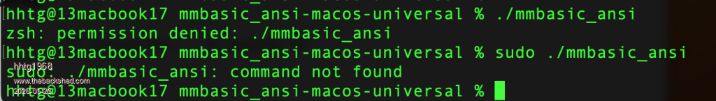

hhtg1968
Joined: 25/05/2023
Posts: 215
Posted: 06:35am 25 May 2026
hello. i am not a terminal expert...
or i am to silly.
hhtg1968
Joined: 25/05/2023
Posts: 215
Posted: 06:36am 25 May 2026
perhaps ist not correct to use "sudo" with "./"
i try further...
jvanderberg
Joined: 06/05/2026
Posts: 86
Posted: 12:52pm 25 May 2026
  hhtg1968 said  perhaps ist not correct to use "sudo" with "./"
i try further...
I've updated it to make it executable by default, something got lost in the build.
But you will face another hurdle, the mac really does not want you to run sus software from the internet, so run this after you download:
xattr -dr com.apple.quarantine mmbasic_ansi-macos-universal
chmod +x mmbasic_ansi-macos-universal/mmbasic_ansi
The first line removes the internet quarantine from the directory, the second make double sure the executable is well, executable.
This is now documented in the readme that comes in the zip file.

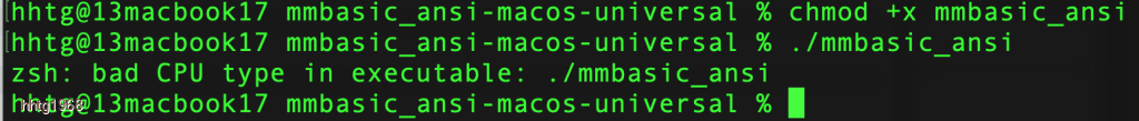

hhtg1968
Joined: 25/05/2023
Posts: 215
Posted: 05:09pm 25 May 2026
@jvanderberg:
i followed your instruction:
... bad cpu type
(i have an intel mac)
jvanderberg
Joined: 06/05/2026
Posts: 86
Posted: 11:50pm 25 May 2026
  hhtg1968 said  @jvanderberg:
... bad cpu type
There was an issue with the build, it should now create a universal binary - I am not at all sure it will run on very old MacOS, but let me know how it goes.

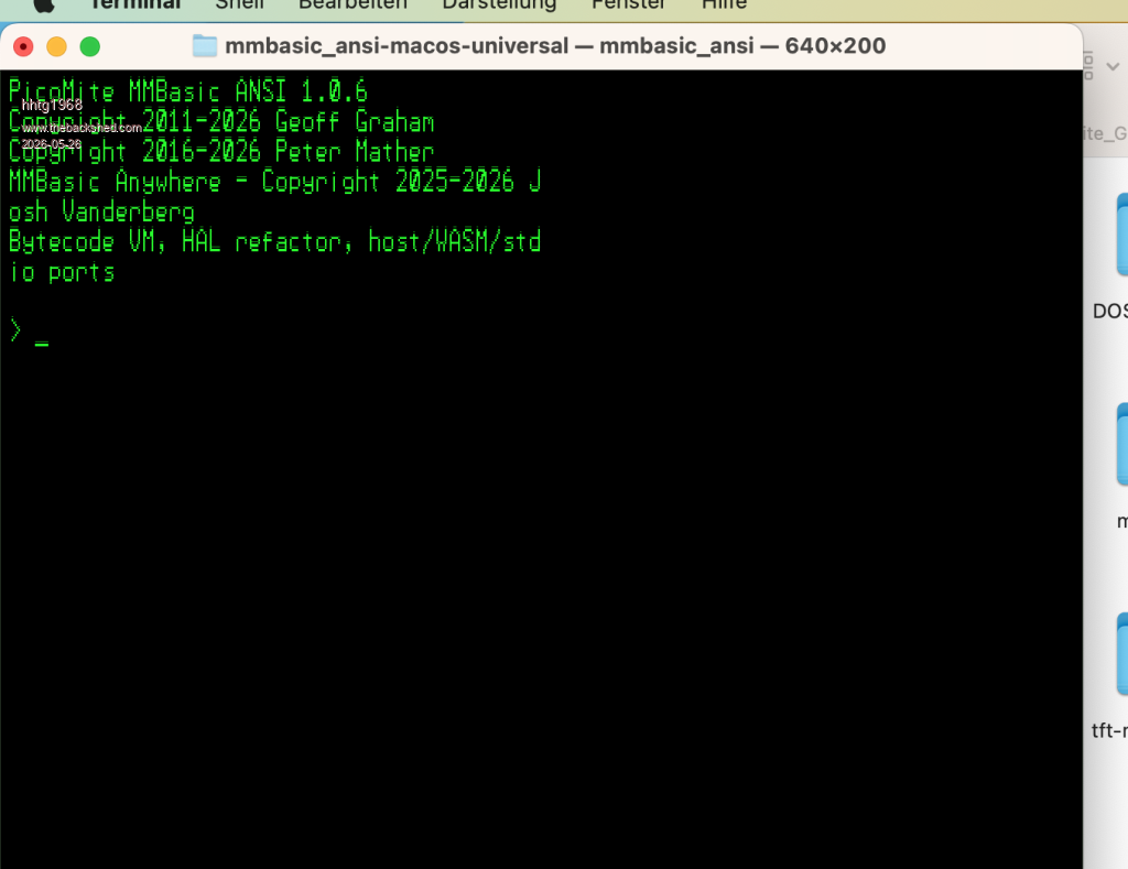

hhtg1968
Joined: 25/05/2023
Posts: 215
Posted: 07:25am 26 May 2026
i have a macbook retine 2017 with macos 13 ventura...
hhtg1968
Joined: 25/05/2023
Posts: 215
Posted: 07:40am 26 May 2026
first successful tests...
hhtg1968
Joined: 25/05/2023
Posts: 215
Posted: 07:44am 26 May 2026
i will further try to get better resolutions etc.
@jvanderberg: thanx a lot...
