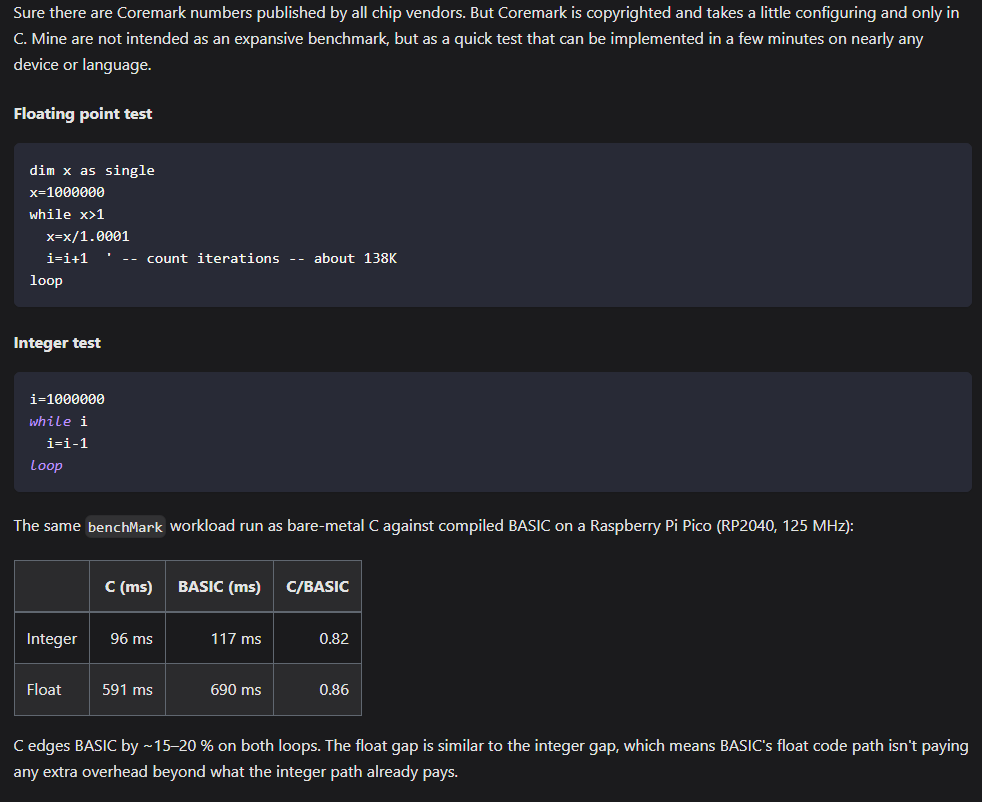

Betas for Pico, Pico 2 and Micro:bit
I have the RP2350 uf2 running on Pete's DIL module.
NOTE: This is the very first release for Pico so don't expect accurate documentation. One minute you think you're reading about the Pico but you ain't

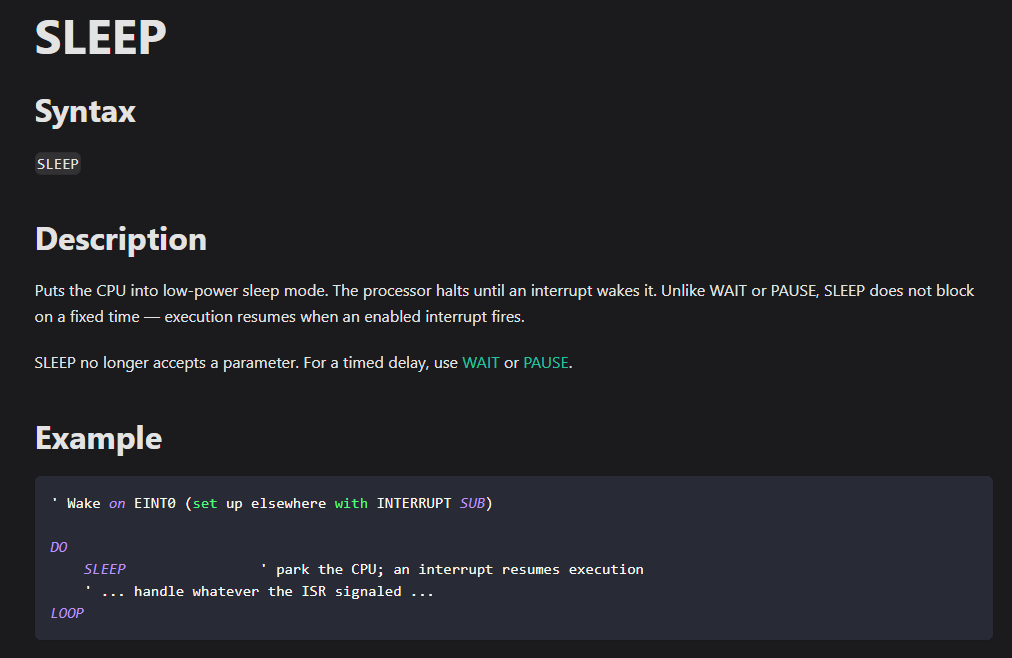

G'day Phenix,
Thanks for the link, only had a quick look but for simple stuff and speed this looks very good.
Also has the one thing the PicoMite lacks, a proper low power sleep mode. Assuming it works of course.
More research required.
Regards, Lyle.

TBH I'm not sure what I'm looking at...  :)
The various low power modes on the RPnnnn drive me bog-eyed when I look at the data sheet!

Hi Lyle,
Yes the SLEEP is what caught my eye because others have mentioned it.
It's so nice to settle on the RP2350 DIL module, running MMBasic and having another, running ARMbasic as a super high-speed peripheral.
I'm currently testing and not surprisingly, it's FAST

Note:
1) Not overclocked
2) Times are for all 1000 iterations
BM1:
2040: 0.383 msec
2350: 0.277 msec
BM2:
2040: 0.332 msec
2350: 0.230 msec
BM3:
2040: 0.859 msec
2350: 0.523 msec
BM4:
2040: 1.283 msec
2350: 0.402 msec
BM5:
2040: 1.362 msec
2350: 0.486 msec
BM6:
2040: 3.111 msec
2350: 1.584 msec
BM7:
2040: 3.721 msec
2350: 1.957 msec
BM8:
2040: 564.388 msec
2350: 95.297 msec

AFAIK the pico does not use a dedicated arithmetic unit like other processors,
but instead uses optimised software routines. So the interpreter and compiled version
probably execute the same underlying stuff, as opposed to a compiler's code accessing a arithmetic/logic unit. The times are slow compared to a more usual processor.
Even crappy laptops are pushing teraflops now.

They seem to be describing something that is a few thousand gates used as an accelerator for software doing math, as a math coprocessor.
Usually a math coprocessor is something that does math ops in a few instruction cycles and is much faster.
(ed) I gather the pico 2 does do some math ops in a few cycles but the speeds above are still slow.
Edited 2026-05-24 21:00 by zeitfest
PhenixRising
Joined: 07/11/2023
Posts: 2149
Posted: 11:07am 24 May 2026
  zeitfest said   but the speeds above are still slow.
The benchmarks on our table are per iteration (time taken/1000)
The benchmarks above are for the FULL 1000 iterations (stated at the top).
