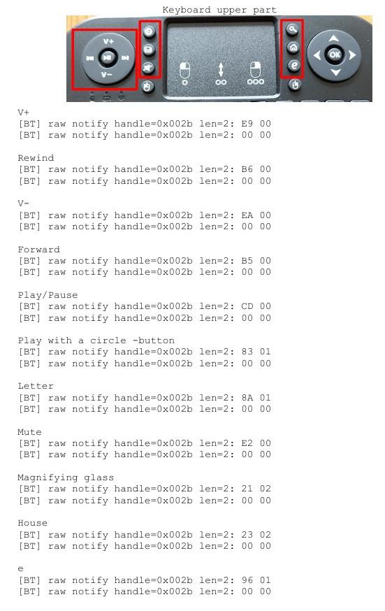

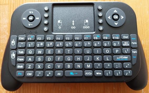

Peter63
Joined: 28/07/2017
Location: Sweden
Posts: 206

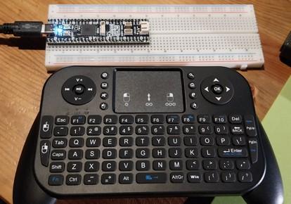

Posted: 02:48pm 22 May 2026
a few more tests I did on the mini keyboard
I can't get the trackpad to work, nor the mouse buttons.
/Peter63

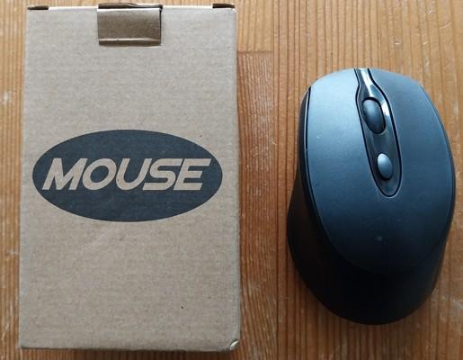

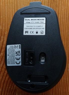

Hello, Peter
I thought I would try this mouse.
I don't really know how to test this, what device number does a BT mouse get?
/Peter63
Posts: 11882
Posted: 07:12am 23 May 2026
  Quote  what device number does a BT mouse get?
It will always get 2 unless already occupied, Keyboard 1, mouse 2, gamepad 3

Tested the mouse with this program:
xold=DEVICE(mouse 2,X)
yold=DEVICE(mouse 2,Y)
x=DEVICE(mouse 2,X)
y=DEVICE(mouse 2,Y)
b=DEVICE(mouse 2,L)
r=DEVICE(mouse 2,R)
m=DEVICE(mouse 2,M)
d=DEVICE(mouse 2,D)
If x<>xold Or y<>yold Then Print "X";x;:xold=x: Print " Y";y:yold=y
If b Then Print "Left mouse button":Pause 200
If r Then Print "Right mouse button":Pause 200
If m Then Print "Middle mouse button":Pause 200
If d Then Print "Double click of the left mouse button":Pause 200
Loop
End
, and it works.
The middle button was the one that did not work on this mouse.
/Peter63

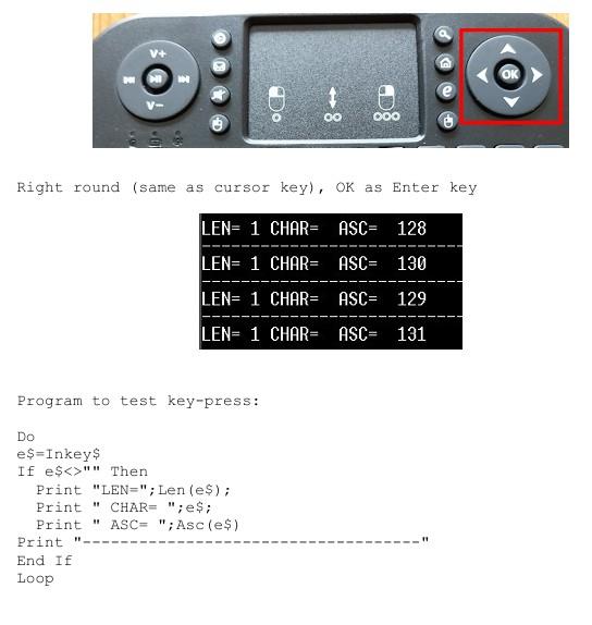

Peter63
Joined: 28/07/2017
Location: Sweden
Posts: 206
Posted: 09:31am 23 May 2026

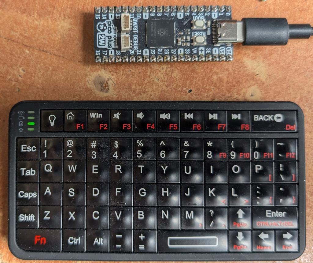

I tested the mini keyboard again. Wanted to see if the trackpad worked, and sure enough it worked. Used the same program that I used when I tested the mouse.
/Peter63

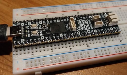

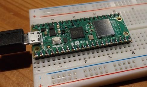

I have tested version RC15 on the original Pico 2W, works fine.
Also tested on Pimoroni Pico LiPo 2 XLW, but does not work.

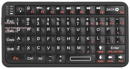

G'day,

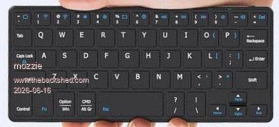

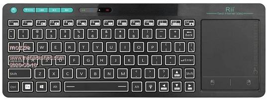

Results of some testing for reference. Original RP Pico2W.

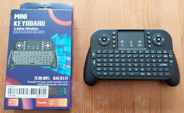

Keyboards listed as BlueTooth 4 or 5 seem to work fine, BlueTooth 3 (only one sample) does not.
Generic "Bewinner" 7-8" bluetooth keyboard, usually comes in "leather" folder for tablet.
Works well, big enough to type on, no backlight.
Generic "Micro" bluetooth keyboard. Do yourself a favour and spend a bit more on the Rii 518bt.
Works, too small for easy typing, has backlight.

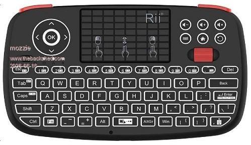

Rii I4 dual mode keyboard / trackpad.
Works well, too small for easy typing, trackpad works, has backlight.
Rii RT518S dual mode keyboard / trackpad. Be careful, the K18 looks identical but is 2.4Ghz only.
Works well, big enough to type on, trackpad works, has backlight.
Rii 518BT keyboard.
Works well, key shape makes it fairly good to type on despite tiny size, has backlight.
The Rii keyboards are a bit more expensive than the generic stuff but seem to be pretty consistant. I have a few others and they survive abuse in the workshop quite well.
Only things that fail to work are the scroll wheel / scroll function and the CAPS LOCK LED.
Thanks again to Peter for implementing this, could prove to be very handy.
Regards, Lyle.

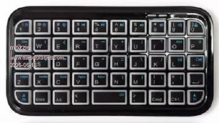

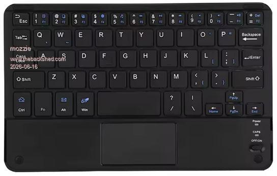

mozzie
Joined: 15/06/2020
Posts: 435
Posted: 04:13pm 15 Jun 2026

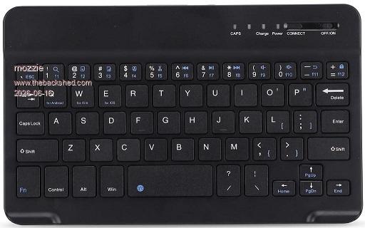

And those that didn't work:
Generic "Magnetic Bluetooth keyboard / touchpad", this shows as "BlueTooth 3"
And be wary of these, no function keys could make life difficult.
Regards, Lyle.

Tested version: PicoMiteBTH MMBasic RP2350B V6.03.00RC24
Just letting you know that my little mini keyboard (BT) works on version RC24
Using-board: Pimoroni Pico LiPo 2 XLW (PIM776)
> option list
OPTION FLASH SIZE 16777216
OPTION COLOURCODE ON
OPTION KEYBOARD US
OPTION HEARTBEAT OFF
OPTION PICO OFF
OPTION CPUSPEED (KHz) 200000
> Bluetooth Keyboard Connected
