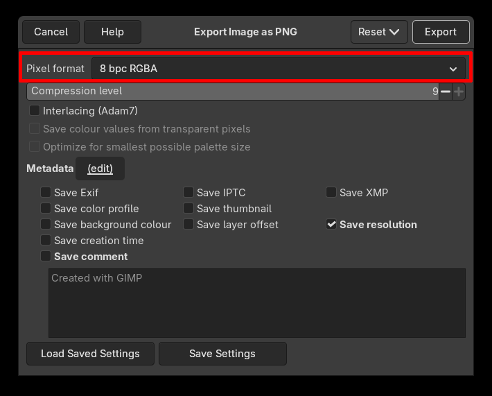

Usually I edit my images on Gimp and export them as PNG selecting the appropriate pixel format
