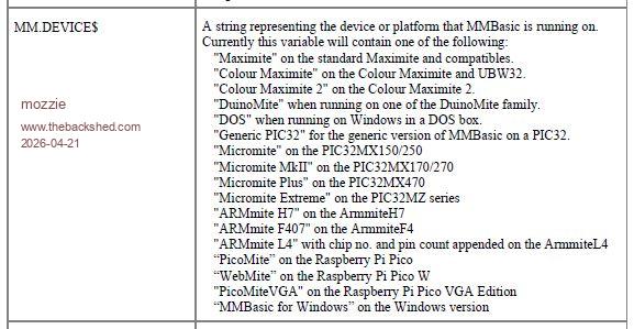

G'day Bill,
Looks like the returns for MM.Device$ went missing from V5.08.00 to V6.00.01
This is the last version found:
I too would have sworn they were in the manual, defective grey matter once again
Regards, Lyle.

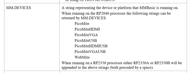

  Turbo46 said  I'm not suggesting that the manual should contain the MM.DEVICE$ text for other versions, just the Pico ones.
Good point Bill (thanks).  The next revision of the manual will have something like this:

Posts: 3372
Posted: 08:49am 23 Apr 2026
Manual updated to Revision 1 in the downloads on my site (https://geoffg.net/Downloads/picomite/PicoMite_User_Manual.pdf).
